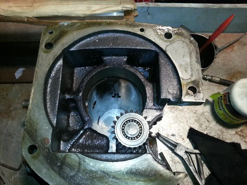

With the quill out the next part to remove was the feed gearbox.
Grease, grease and more grease laugh
View down the quill housing

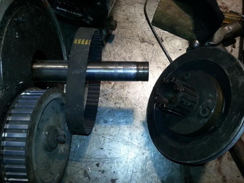

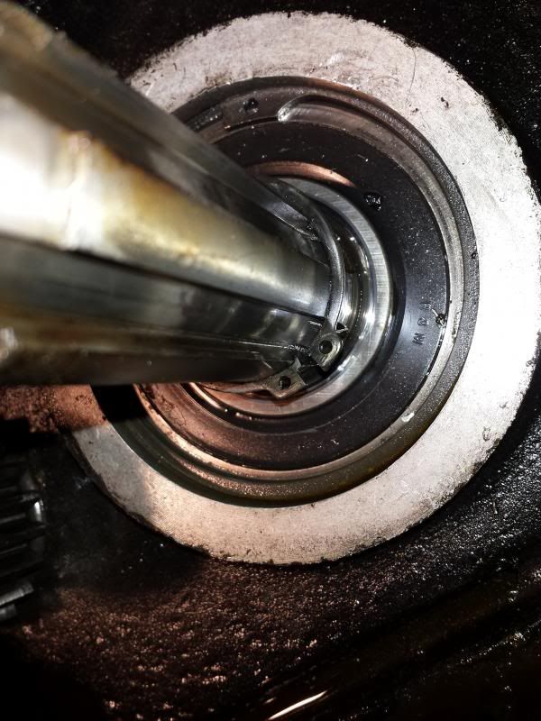

With the quill and gearbx outta the way I turned my attention back to the top part of the head. Remember the brake attachment on the top of the spindle that I couldn't get undone? Turns out it is screwed onto the spindle. With the quill removed I was able to lock the spindle and undo it.
and then pull the bearing off.
I was then able to pull off the top pulley and remove the toothed belt.

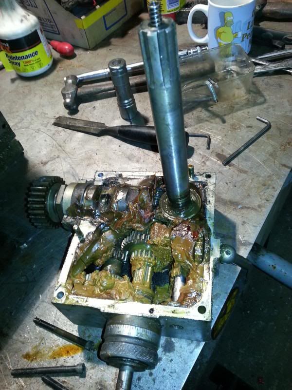

Next job was to try and get into the gearbox, easier said than done smile o

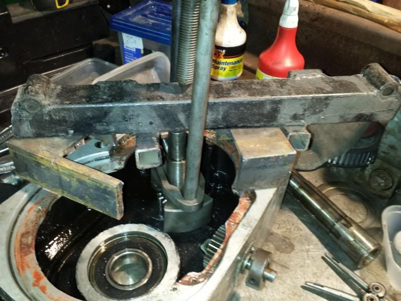

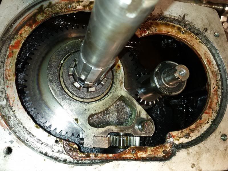

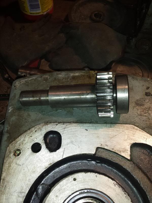

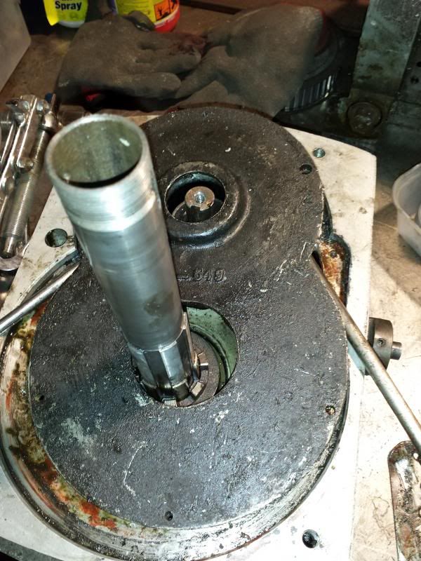

So, not sure if anyone is still reading this, can understand though - its probably not that rivetting just seeing something pulled apart embarrassed.

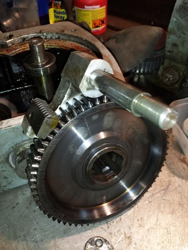

Anyway, for posterities sake, started to dissassemble the gearbox which as well as transferring drive from the pulleys to the quill, also handles the backgear.

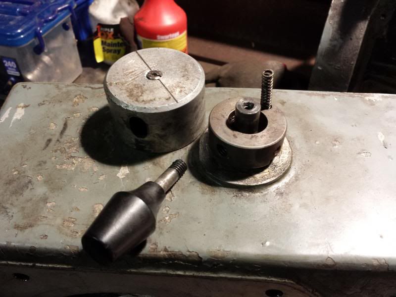

First of removed the back gear lever, note spring that maintains the "detente" position on the lever,

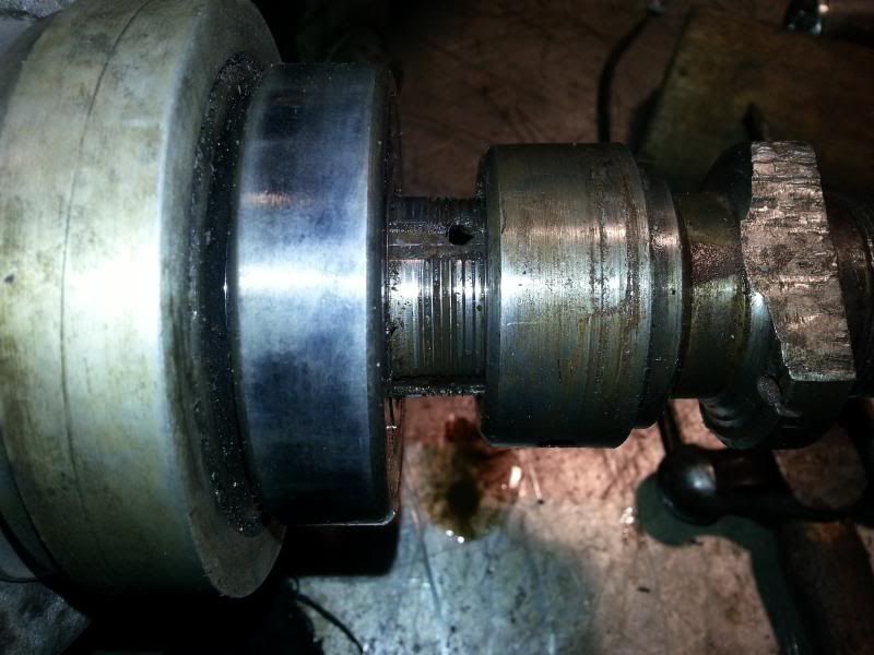

The output shaft of the gearbox has a cog retained with a circlip. Circlip was removed and then a puller used on the gear revealing the woodruff key and rubber o-ring.
Flipped the 'box and attacked the top. The cover plate is held in by 4 screws but still wouldn't pop off. It turns out the backgear shaft has a bearing on the top end of the shaft which locates in the plate. To get the plate off you have to slide it off this bearing, but without anywhere to locate a puller its a bit of a job.
Eventually levered it off.
This is the insides of the gearbox, backgear shaft on the right and backgear selector hanging off the main shaft.
Backgear selector, wheel and clutch slid off the shaft
The shaft sits in a large bearing that sits in the bottom of the gearbox covered by a retaining plate on the underside and held in by the large circlip you can see in this picture.
In the above picture you can also see a smaller circlip on the shaft itself, this is why the shaft cannot be withdrawn from the bottom of the gearbox and has to be removed via the procedure described above, i.e. from the top.
With the main shaft out of the way I could then proceed to remove the backgear shaft. Some improvisation with another gear puller smile o
and the shaft complete with lower bearing comes out.
Next step, pressing out the main bearing and dropping the casing in the solvent tank, unfortunately I got a little bit distracted by purchasing and setting up this wink

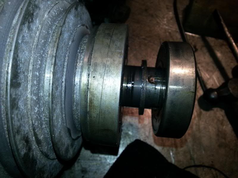

Hey Harry, info on spindle brake as promised.
The brake sits on top of the pulley housing and acts on the top of the spindle.
The lever operates a set of expanding shoes via a cam on the end of the lever
The brake shoes act on the inside of a drum
and when it is all assembled the drum sits kinda like this
So the drum is locked to the spindle and rotates and when the lever is pushed over the shoes expand onto the drum and hence brake the spindle.
Hope that makes sense

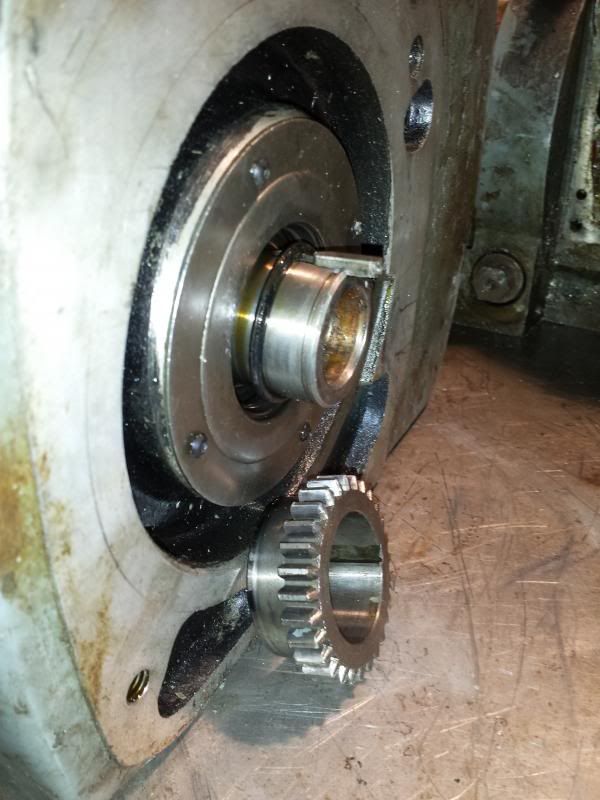

OK, back on track. Walked over the shed with the casing and pressend out the main bottom bearing.
There is a thin circular plate held on by 4 tiny screws that has to come off first. The bearing and seal is oriented like this.
Then moved onto striping the bottom section of the head, starting with what I think is the idler gear.
Then the bushing that the pinion shaft sits in (IIRC frown)
And the feed disengagement shaft/pinion
Removed the clutch box cover
Close up view showing location of circlips and pins
Removing the gear from the pinion shaft
Revealing another circlip on the shaft itself, hence why you wouldn't be able to remove the shaft without coming in from the clutch end.
Shaft removed
View inside the clutch cover showing how the clutch lever is located
And finally, removed the worm shaft from the head/overarm
Thats the head pretty much stripped now.
