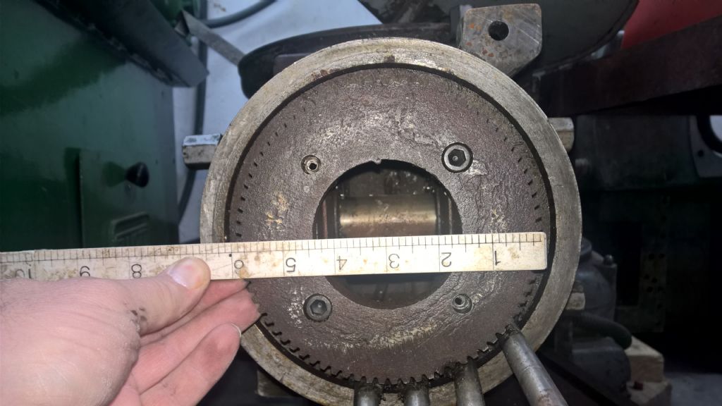

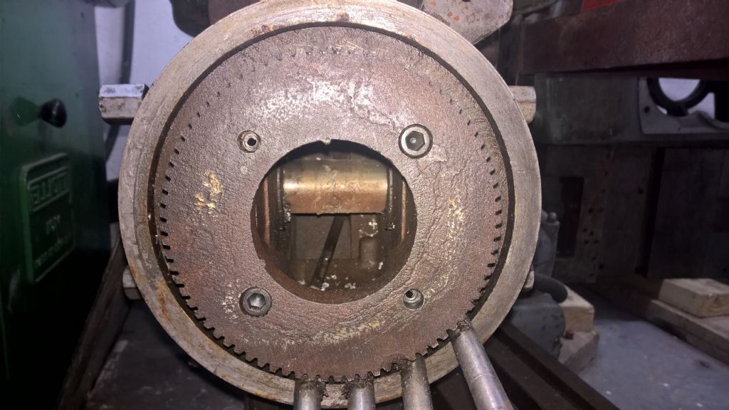

Hi Alan,
sorry its taken so long to respond but here are some more photos of the gear. It looks to me like it is bang on 6 inches diameter. I'm afraid I didn't have time to count the teeh but hopefully the photos are good enough that you can do that from enlarging them smiley
Cheers,
Paul.

09/10/2016 16:40:13
2016-10-09 16.33.09.jpgNot sure if it helps but here are pics of my gear, seems to show that the gears on mine are bevelled not straight cut like yours! (probably the wrong terminology but you can see what I meansmiley)
No idea where the spindle is so couldn't take a photo of that frown
Cheers,
Paul.

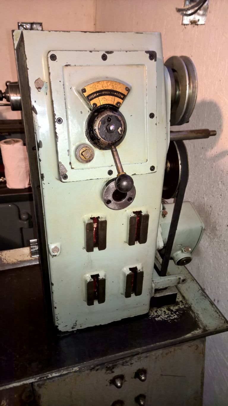

10/01/2016 10:16:49

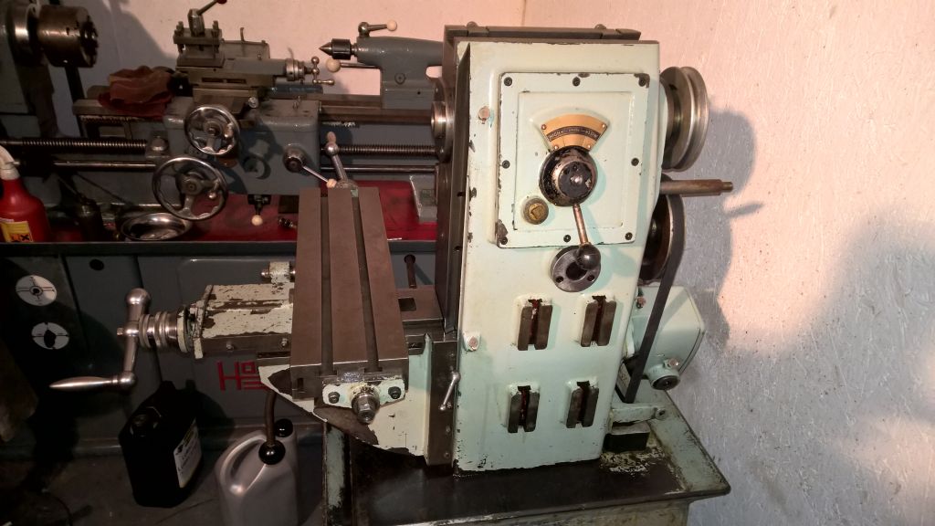

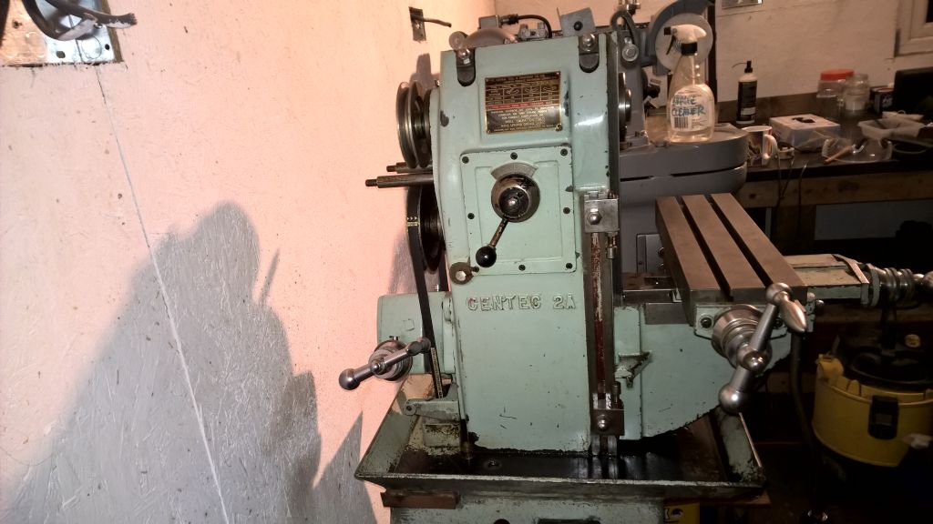

So go onto cleaning it up over Christmas. Stripped the head, table, saddle and knee off and gave everything a thorough clean.
Actually was in quite nice condition, you can se ethe flaking on the column which I am guessing is from manufacture
Set about clenaing all the grime off the case, pulley etc.
Was able to get the saddle and knee set up nicely with the gibs with pretty much zero play. The table has more wear in the gib so was a bit more tricky but worked out OK with a bit of tightness at full right position. If I get a chance I might get/make a new gib strip and get the table ways scrapped but not esential.
Leadscrews have about 5thou backlash which doesnt seem to want to adjust out but I can live with that.
And all reassembled, haven't attacked the stand yet so that is still a bit grubbydisgust
Filled the box with Lumach 100 from Alex Oils which seems to be a close match for the original Vitrea 100.
Cheers,
Paul.

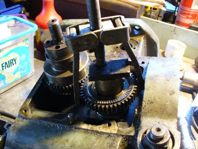

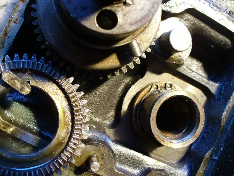

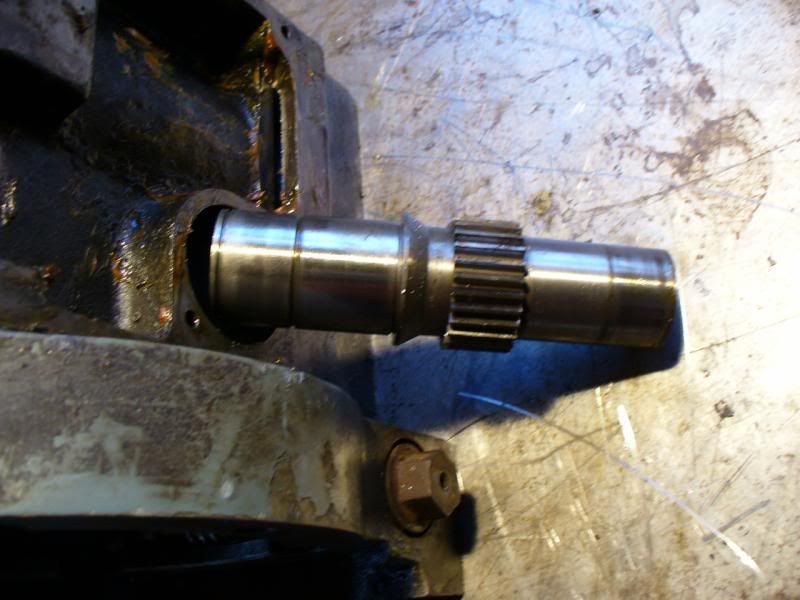

08/03/2014 21:59:59

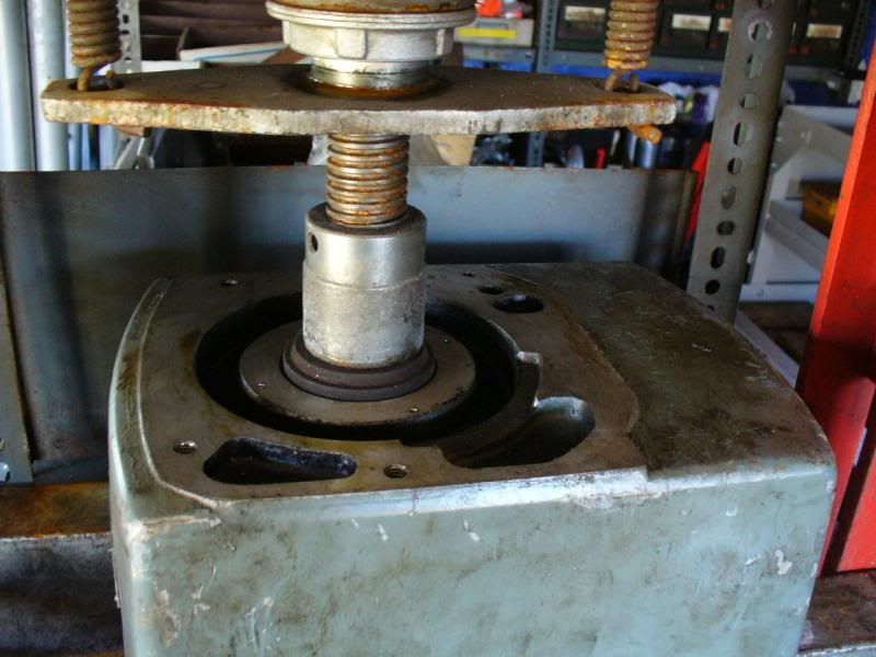

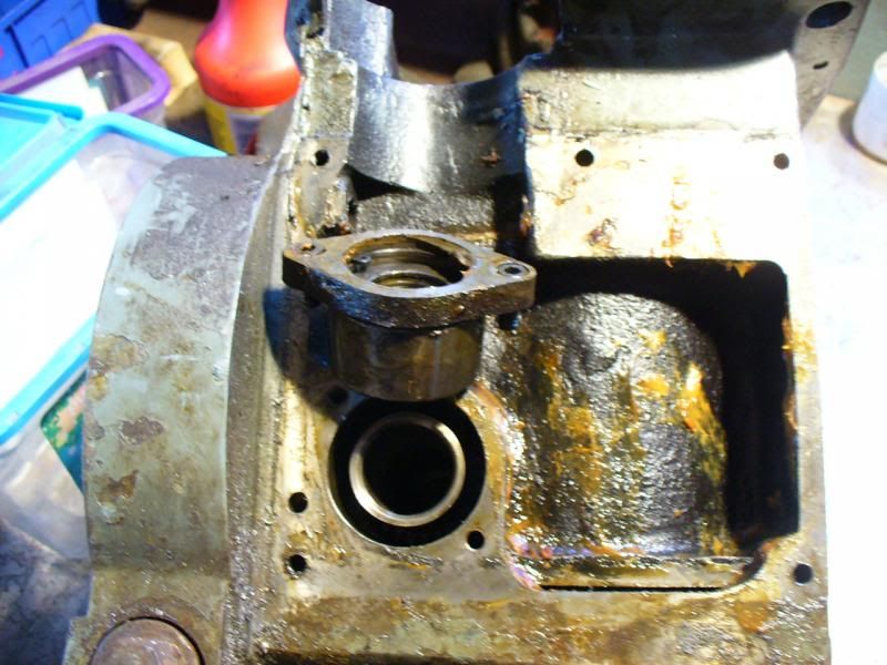

OK, back on track. Walked over the shed with the casing and pressend out the main bottom bearing.
There is a thin circular plate held on by 4 tiny screws that has to come off first. The bearing and seal is oriented like this.
Then moved onto striping the bottom section of the head, starting with what I think is the idler gear.
Then the bushing that the pinion shaft sits in (IIRC frown)
And the feed disengagement shaft/pinion
Removed the clutch box cover
Close up view showing location of circlips and pins
Removing the gear from the pinion shaft
Revealing another circlip on the shaft itself, hence why you wouldn't be able to remove the shaft without coming in from the clutch end.
Shaft removed
View inside the clutch cover showing how the clutch lever is located
And finally, removed the worm shaft from the head/overarm
Thats the head pretty much stripped now.
Might move onto cleaning, painting and stuff like that next so I can get some of this re-assembled before I loose any parts or forget how they go together crying
Cheers,
Paul.

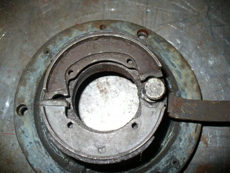

08/03/2014 21:20:12

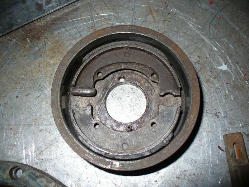

Hey Harry, info on spindle brake as promised.
The brake sits on top of the pulley housing and acts on the top of the spindle.
The lever operates a set of expanding shoes via a cam on the end of the lever
The brake shoes act on the inside of a drum
and when it is all assembled the drum sits kinda like this
So the drum is locked to the spindle and rotates and when the lever is pushed over the shoes expand onto the drum and hence brake the spindle.
Hope that makes sense
Cheers,
Paul.
Edited By Paul Major on 08/03/2014 21:22:38
