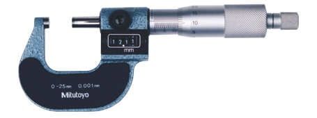

Kevin F02/08/2014 15:39:53
96 forum posts
24 photos
by Michael Gilligan on 31/07/2014 22:50:06:
Slightly off-topic, but you guys with Classic digital micrometers might apprciate these.
[of course they are only "digital" in the human interface]
I have a later type of counter micrometer

Paul Tummers03/08/2014 00:22:48
16 forum posts
Posted by Kevin Fenrich on 02/08/2014 15:39:53:
I have one of those, they are very good tools and accurate. What I like especially is that the Moore & Wright has spring tension which improves accuracy in taking measurement very much.
