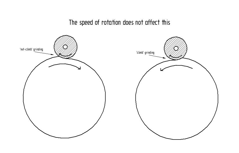

Chris, could you try to imagine what it is that Martin and I are on about? I can assure you that it's true... and it's not a speed issue.

In an attempt to make it easier to see what it is we are on about....
Gone Away27/10/2010 22:48:44
829 forum posts
1 photos
If the analogy is to milling (conventional vs climb) aren't the labels reversed on the diagram?
Steve Garnett27/10/2010 23:34:34
837 forum posts
27 photos
Er, yes... whoops! I'll redo that bit. Doesn't alter the principle, though.

I should point out that I do not know what difference it makes (apart from where all the dust flies), although the effect will surely be small. The contact angle will be very slight, and if the work and the grinder are both rigidly mounted, then presumably you wouldn't get the problems you get with climb milling anyway. I had a look at several other sites where people talk about which way they do this, and there seem to be an equal number in both camps. And I have a completely open mind about it...

Steve Garnett28/10/2010 00:56:29
837 forum posts
27 photos
Nick, they have been reversed in the only version currently in the thread.

Hi
Steve, thanks for the diagram, comfirms what you've been saying.
If the work is held between centres then you will have to 'not climb grind'? Am I right?
Maybe way back this is where the need for the grinding wheel and work surfaces moving in opposite directions originated, I would imagine in days gone that working between centres would be more common.

Steve Garnett28/10/2010 10:16:07
837 forum posts
27 photos
Posted by tractionengine42 on 28/10/2010 01:41:32
Well I'm glad that somebody's seen the point... but I don't think that the way the work is mounted makes any difference. In the diagram, the centres would be aligned through the page, and  you could easily arrange to turn the work either way.
What on the face of it appears to be happening is that with climb grinding, the wheel leading edge attacks a fractionally larger amount of material, and in fact it's easy to demonstrate that the faster the work rotates, the greater the attack amount is. With non-climb grinding, the opposite happens; the grind wheel attack amount is at a minimum, and this increases progressively through the contact. So the speed the work rotates in either scenario determines the rate at which a very small amount of material is removed.
What I don't know though is how much difference this makes - we are talking about a very small contact area, certainly with a typically small wheel. But if there is going to be any difference in the results, this is where it will have come from, because it's the only other mechanical effect involved when you've removed rigidity issues, etc. I'm quite prepared to believe that it's a red herring - that's fine, as long as I've at least attempted to understand why!

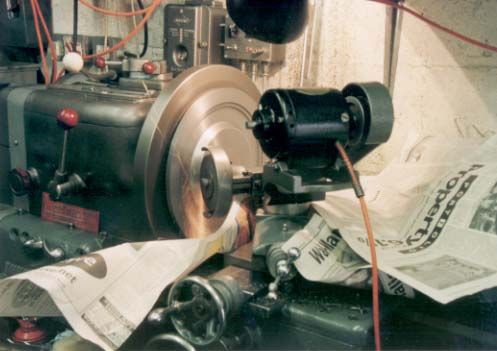

WALLACE29/10/2010 09:57:59
304 forum posts
17 photos
Just an observation - the commercial toolpost grinder I have doesn't have a forward / reverse switch on it  - even though originally it came with an internal and external wheel head (internal one's missing - something to make up one day . . !).
May I should fit one .  .
w.

Whether you could do this safely rather depends on how the wheels are fitted and retained on the heads. If they are held in place by any sort of screw threaded arrangement it could potentially undo itself if reversed, unless steps are taken to prevent this. And of course it has to have a motor that's capable of being reversed...
WALLACE29/10/2010 14:17:52
304 forum posts
17 photos
Hi Steve.
You have a very good point !
Seem to remember the bolt holding the spindle drive pulley is reversed thread, the one on the grinding wheel is  normal.
I shall leave as is . .
Incidently, I only used it once to skim off a flywheel  -see below  - looking at the switch on the lathe, I reckon it was going clockwise . .
W.
Edited By WALLACE on 29/10/2010 14:20:01
