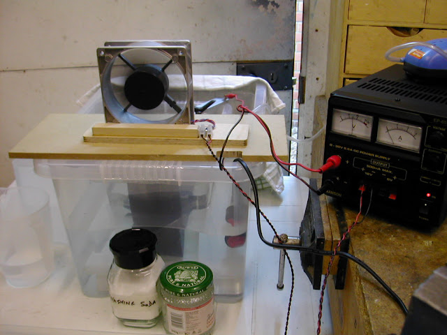

Had another go today with the new set up but still using the original acid in the ano tank. This time the tank is placed in a larger one filled with water which is heated with an aquarium heater (24 C). The ano tank has an 'agitator' made from an ali tube drilled with smallholes and fed by a small aquarium air pump and the test piece was suspended on a piece of titanium strip. A milli-ampmeter really needs to be in circuit as the amp meter on the unit is too 'coarse' to get a reading on - back to the test meter then though if the parts get larger or the part count goes up then the current will need to increase relative to the surface area
A 50 min dose at 15 volts followed by a lengthy soak in the dye (I confess I forgot about it for an hour or more) - correct anodising dye that is, from the ebay link you posted Terry - saw this result.

I noticed however that to increase the current that the volts needed to increase - the ammeter on the unit not registering such a small amount. There are varying recommendations from 3 to 6 amps a square foot - the part shown worked out to 27 milliamps though it was not possible to check the actual current on this one.

One thing that increases current is to move the electrodes closer, and or enlarge it. Hook up an ammeter in the line, and have good heavy cables- if they start to get warm a bit more copper won't hurt, just don't over load the power supply, I,v done that. Ian S C

I began as said by changing the electrolyte. The 4 to1 that I had in store was not quite enough so had to add some of the 10 to 1 - at a rough calculation it worked out about 6 to 1 so I added a bit more neat acid and this new mix appears to have done the trick.
I also added the test meter in circuit and this was a big improvement in being able to monitor the current . I noticed this did not drop at all as the time increased though this did happen on that initial jury rig set up. I think that this is probably due to the better and constant contact of the Ti hanger strip as opposed to the ali ones used previously which were obviously anodising at the same rate and probably reducing the contact area.

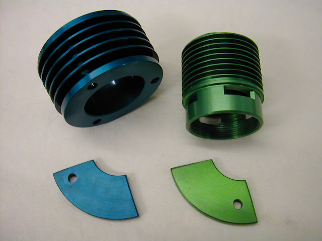

The second test then was at 12 volts and a consistent 30 ma for a 50min duration. Using the ano dye as for the previous test the take up of colour began immediately though quite faint,  the result below (centre piece) was after 20 mins in 'hand hot' dye - a much better colour take up and nowhere near as drab as expected.
The third piece on the right was done exactly the same but was dipped into Parker green ink. The take up of colour was virtually instantaneous and the result you see was no more than five seconds exposure! I sealed this one in steam but notice this has caused very faint blotching however the parts look much better 'in the hand' than the pics allude to.
I must admit that despite the green actually being closer to a blue I was really surprised with the colour absorbtion of the ink. This was neat ink and I think perhaps too strong so will try diluting it and see if a longer soak provides a more deeper and uniform finish.
The big thing is that the process now appears to be working quite well and just needs tweaking. I shall do several more test pieces to be certain before any of the Racer parts but must admit with the bottom ends of them all assembled I'm itching to get the tops done and try them out - "ahh patience laddie"

Well after a few more test pieces I finally bit the bullet and did what I set out to do and have to say am very pleased with the results.
I did the smaller 'DC Rapier' head first using the initial green dye from Terry's ebay link. As you can see the previous test piece gave a different hue. I think this was due to when transfering the dye into a glass jar I noticed there was quite a bit of sediment in the bottom of the bottle so gave it a real good shake. Typically the shade of the test piece is more the shade I was after however the finished item looks okay in situ on it's crankcase.
The cylinder off the Racer was done in 'Parker' green ink and has this lovely bluey green shade. However despite using the same current and very careful timing both in the ano bath and the dye the second cylinder came out a lighter shade. It was put back in the dye for a further 15 mins but no increase in colour occured. I'm surmising that this is due to the gradual depletion of the dye as each part is done. Though it did not occur to do so at the time, the amount of dye available was insufficient to do two parts at once but that is how I would do it the next time if I wanted to get two parts or more the same shade.
Whatever I have had an enjoyable time learning how to carry out this process and it has added another dimension to the making of small I/C motors and bodes well for the future. That OPS marine can now finally have a red head!
