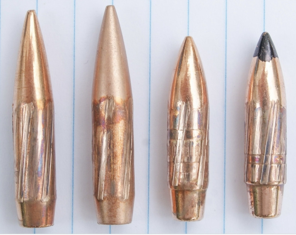

It doesn’t look much like rifling marks.
SillyOldDuffer08/03/2022 14:25:03
10668 forum posts
2415 photos
Posted by Clive Hartland on 08/03/2022 13:15:06:
I agree the .375 calibre but have never seen pointed boat tail bulets used in an H & H .375. ...
That's why I posted photographs of pointed boat tail H&H .375 bullets and linked to the webshop where you can buy them (legalities permitting).
Same webshop also sells round nosed and blunt bullets exactly of the type Clive mentions, but trust me they aren't the only type available. Sharp pointed boat-tailed 0.375 bullets aren't unusual, at least in the US.
Thanks to Vic for the lovely clear photos of rifling marks. I spent a good 40 minutes looking on the web without finding any. Ho hum.

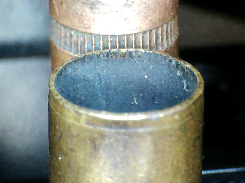

Posted by Mick B1 on 08/03/2022 12:55:31:
Nick,
I think you have a standard US military .30-06 ball round made by Remington Arms of Bridgeport CT in 1943.
It's probably M2 Ball with a 152-grain bullet at a nominal MV of 2,805 ft./sec.
I suspect it's been fired in a military weapon with slightly relaxed chamber tolerances, from the mild swelling at the case web ahead of the extraction groove.
Edited By Mick B1 on 08/03/2022 12:59:41
Hi Mick, thanks for your information although I'm not familiar with the technical jargon. The actual weight of the bullet, which I didn't think to include, currently weighs 11,1793 grams.
Regards Nick.
Mick B109/03/2022 09:33:30
2444 forum posts
139 photos
Posted by Nicholas Farr on 09/03/2022 08:53:29:
Regards Nick.
About 172 grains, and flat based, so not M1 or M2 ball.
Opens the question of where your bullet came from, then. You've got a case that's been fired at full pressure, and a bullet that hasn't. It looks as if the bullet may not've come from an identical round to the case. An outside possibility is that it's an American-made .303 calibre bullet (actual diameter nominally .311"  ). A normal .30 calibre bullet would measure .308" diameter, but a .311" might finger-fit into an expanded fired .30 caseneck.
Dunno....
surprise
Edited By Mick B1 on 09/03/2022 09:34:04
SillyOldDuffer09/03/2022 10:32:57
10668 forum posts
2415 photos
Posted by Michael Gilligan on 08/03/2022 17:50:39:
Posted by SillyOldDuffer on 08/03/2022 14:25:03:
That's why I posted photographs of pointed boat tail H&H .375 bullets …
Sorry, Dave … Can we please distinguish between ‘pointed’ and ‘conical’
All of the images you have posted have, I believe, ogival shapes [regardless of the sharpness of the very tip]
No, I meant to draw attention to the shape at the end of the cone - the point or tip.
Bullets and shells often have a conical shape where the curve is defined as an ogive. However, it's the tip I'm interested in because it's exact form depends on the intended target. Large animals are shot at relatively short range (less than 250 metres) with a heavy blunt bullet designed to deliver maximum energy to the target by not coming out the other side. Conversely, long-range requires an aerodynamic bullet with a long sharp cone at the front and a curved 'boat-tail' at the rear to reduce drag. Improved aerodynamics reduce the weight of the bullet, and the shape means they are more likely to pass clean through animals, thus causing less damage than they could. Long range shooting at animals is unkind and stupid, because it's more likely to cause painful non-fatal wounds than a clean kill.
The mystery object comes to a sharp point (albeit rounded at the very end) rather than being blunt or round like these examples:
All I'm saying is the mystery object is consistent in size and shape with a long-range 0.375 H&H bullet like this Nosler example:
The examples pictured in this post are all hunting bullets, designed to expand on impact. This is undesirable when target shooting, so it's possible to buy solid bullets in 0.375 H&H specifically intended to fly long distances with minimum deviation to punch a clean round hole in a sheet of paper.
Irrespective of tip form, the examples are all genuine 0.375 Holland & Holland cartridges. As the sharp pointed H&H bullets are very similar in size and shape to the mystery object, I'm moderately confident it's a .375 H&H, make and age unknown. (Digging around the web, I found .375 H&H is a British round developed for African game during the Empire. The mystery object might have been made in the UK long ago. Does anyone have any old H&H catalogues?)
I see Nick got the mystery object's weight - about 11.2g. This is about 173grains, which is lighter than all my examples:
Nosler = 270gr = 17.5g
Federal = 300gr = 19.4g
The mystery object's light weight suggests it's a target or match bullet, which I think Mick said early in the thread.
Nicholas Farr09/03/2022 11:25:06
avatar
3988 forum posts
1799 photos
Hi Mick B1, I don't know any history of the bullet and casing, but the bullet was in the casing and I had to reshape the out of shape open end with a little light peening, using a 7.9mm twist drill and a small brass hammer with a nylon head to get the bullet out, but it was still a bit tight to get out and I had to grip the bullet in a cheap ally vice from Aldi's with rubber protectors on the jaws, while wriggling the casing off. The other casing had no bullet in it, but the open end still has a slightly crimped edge and remains of knurling's on the inside that match the pitch of the knurling's on the bullet that I've shown, but of course it may be a marriage as you suggest.
Thanks again for your info.
Regards Nick.
