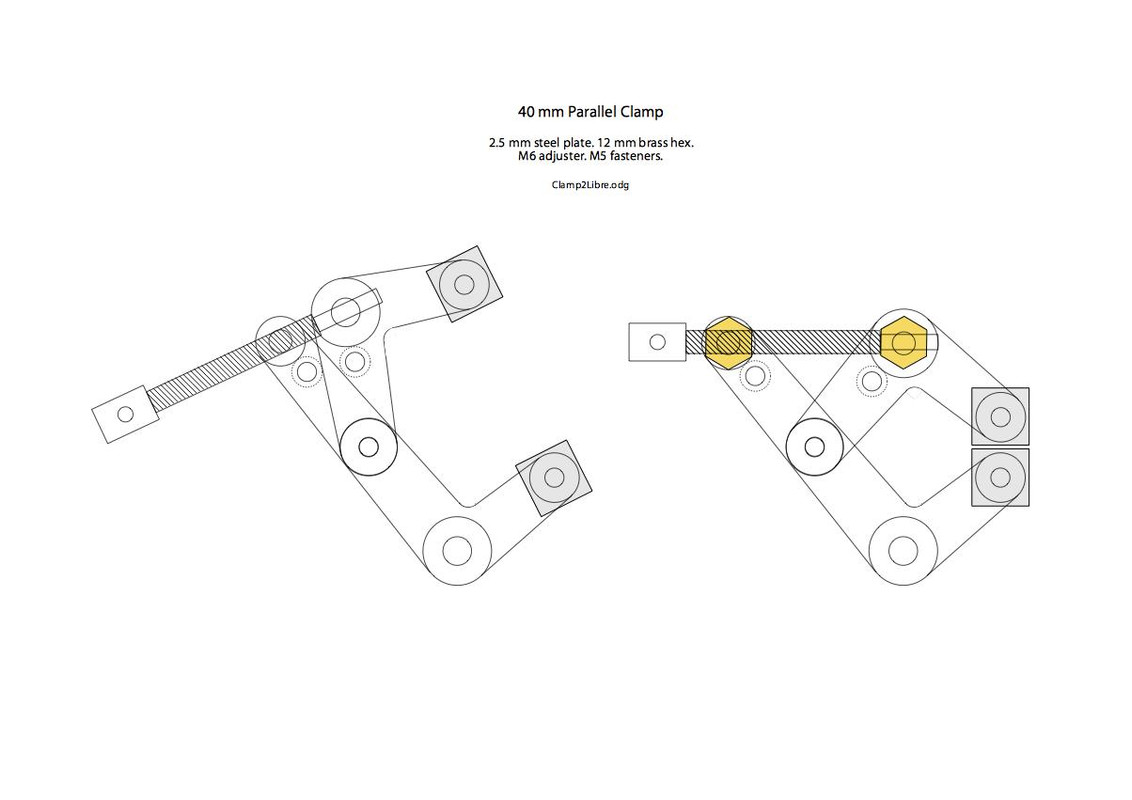

A quick sketch in OO.

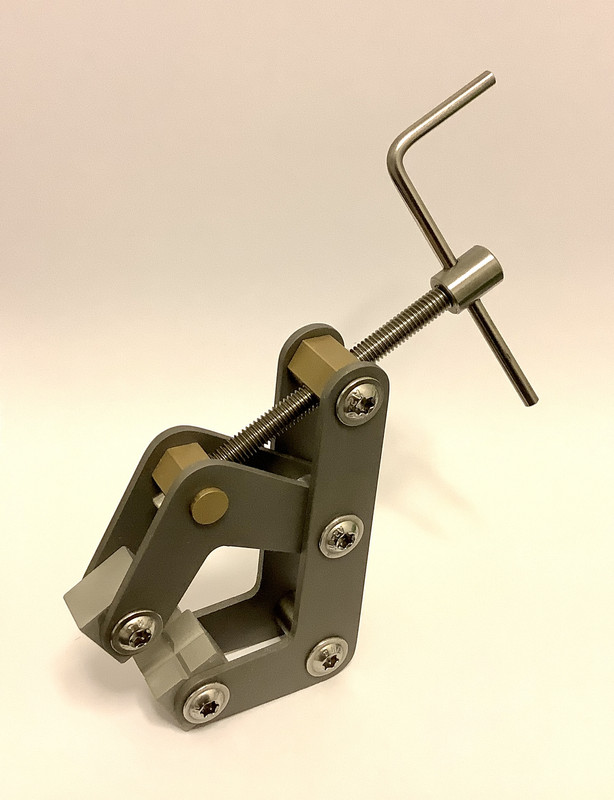

Finished. I won’t be making any more unless I find I really need them and I can get the plates water jet cut!
Mostly stainless with some brass and alloy. Using hex bar for the bosses proved to be a good call.
Michael Gilligan24/12/2021 18:44:01
avatar
23121 forum posts
1360 photos
Very tidy, Vic yes

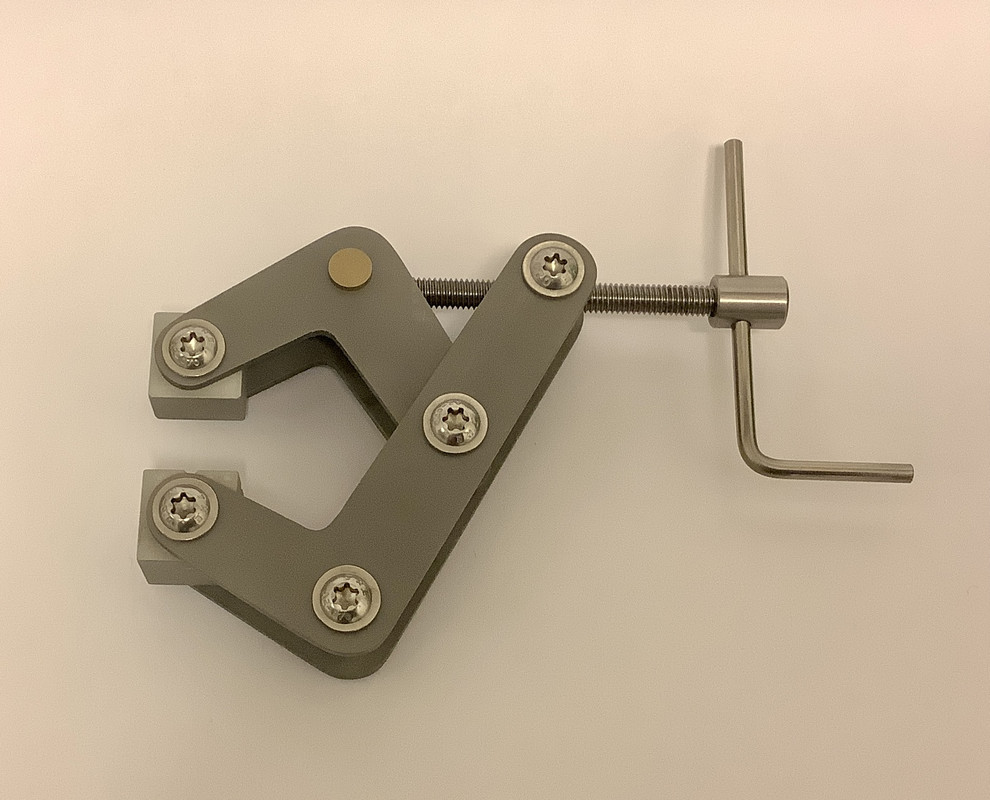

Vic25/12/2021 10:45:44
3453 forum posts
23 photos
Another view in case it helps others contemplating making one.
