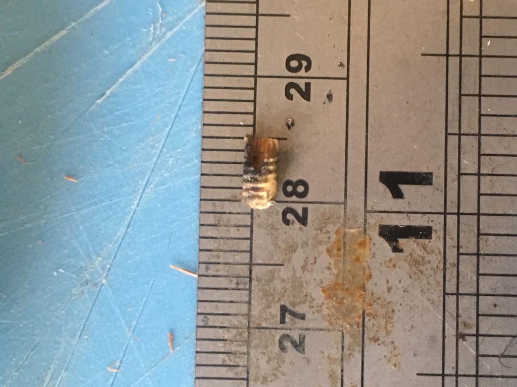

Sherlock06/08/2018 16:13:55
52 forum posts
11 photos
Posted by Michael Gilligan on 06/08/2018 16:00:28
Steve,
My apologies if I did not make this explicit, and have let you into difficulty:
Absolutely no apologies needed Steve. the problem has been not having a suitable plastic to hand that was strong enough.
I apologise in advance for this, but, when I screwed the third attempt out (maybe a turned down wooden chopstick) I was left with this which shows three threads. I know it's a terrible result and photo and wasn't going to send but just incase...

Michael Gilligan06/08/2018 18:18:31
avatar
23121 forum posts
1360 photos
O.K. this is my best estimate from your latest photo, Steve:
I think that's as near to 40tpi as you will get from measuring five threads with a chopstick.
Edited By Michael Gilligan on 06/08/2018 18:35:03
Michael Gilligan06/08/2018 18:25:09
avatar
23121 forum posts
1360 photos
Posted by Frances IoM on 06/08/2018 16:11:41:
the original Perris from which the ME90 derives used BA for most sub 0.25" screws - usually 4BA but think there were a couple of 2BA - might be worth buying a couple of these as testing the thread per MG is a right pain - much easier to have a selection of known screws and see which fits
I'm struggling to follow the logic, Frances
The toolholder is an 'aftermarket' item, so Perris and Cowells would seem to be irrelevant.
Based on the latest hyper-accurate measurements, 4-40 UNC looks a good candidate.
Edited By Michael Gilligan on 06/08/2018 18:29:10

Sherlock06/08/2018 20:52:39
52 forum posts
11 photos
Posted by Michael Gilligan on 06/08/2018 18:18:31:
Valiant effort Michael Thank you. Up until I started this thread, I had never even heard of the British Association thread standard! so I have learned a lot.
