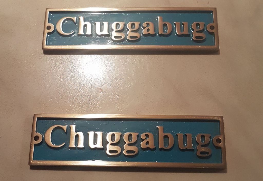

A while back I posted on this thread on making some Tich nameplates - here's the finished articles, thanks to John Lintorn for letting me post this picture.
