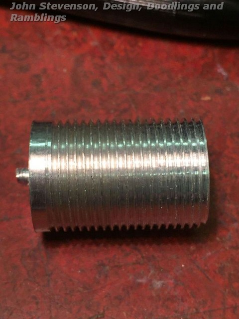

John Stevenson16/09/2016 20:00:20
avatar
5068 forum posts
3 photos
Deal direct with Newkye.
Dear Mr.John Stevenson,
Have a nice day, I will give you the best price for your order , NEW990TDb-2 is $370,so 2 pcs with freight is $930, do you need servo motor and driver?
With kind regards,
Alisa Zhang
Foreign trade manager
Taizhou Newkye Electronics CO.,LTD
www.newkye.com
So at the time this worked out to £720 UKP then £15 handling and £88 duty to be paid on two units.
As I was able claim the £88 back, this worked out to £367.50
Today's prices may be different because of the exchange rate.
This is for a commercial unit that handles all common G Code that Mach and Linux can handle plus many more specialised ones. Can handle steppers and servo's, spindle off / on and speed. Screw cutting and tool changer without needing any external control cards or third party support, or from past experience third world support.
The first of these units has been fitted to a Denford Orac and is running test code at the moment.
This is it's first thread straight out of the box.
Something we have waited years for a thread that works and a decent GUI.
