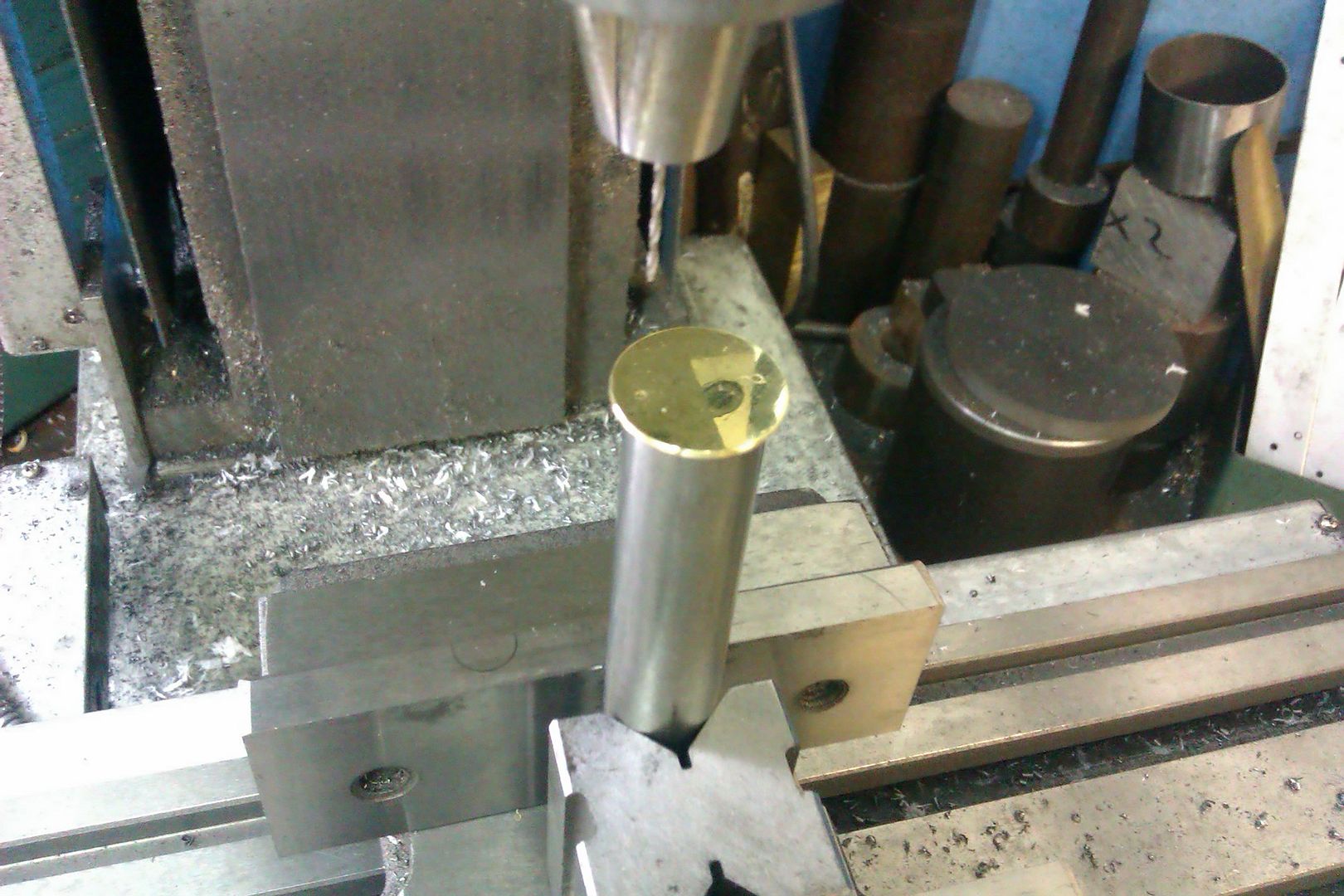

My first wax chuck made from a 12 X 30mm brass hex head bolt. 12mm was the largest brass bolt anybody had in Cairns. I also want to make more wax chucks from 16mm and 18mm brass bolts but I will have to buy them from Hong Kong. They cost about $7 each.
The wax chuck was polished on a sheet of glass using 1500 and then 2000 grit sandpaper. I have not had a chance to use it yet.

Does it have to be brass?

Posted by pgk pgk on 19/10/2015 09:19:56:
Not if you are using modern adhesives such as SuperGlue
However: Traditional Watcmaking technique uses Shellac; which is melted with heat, and permits the job to be centered whilst the Shellac is still soft. The thermal characteristics of brass seem better suited to this.
Note also that the Watchmaker's stubs are typically fitted into a collet and trued-up or modified for a particular job [Brass is more easily worked]
Edit: useful illustration, here
P.S. That page also has some helpful comments regarding M14 threaded chucks.

Brian, you don't have to use a bolt, just get an offcut of suitable bar and turn down one end to fit the chuck. Come to think of it you don't even need to reduce the dia just face off the bar as is and stick your work to that.
Here is a bit of bar being used, turned the roughly cut plate round on the lathe and then over to the mill to drill, no metal wasted makeing special chucks, just faced off a bit of bar.

Jason : but doesn't the face have to be highly polished to get a good glue joint ? I was following instructions on one of the above links on wax chucks.The shape of the bolt is also good for polishing by hand on a sheet of glass. I could make this shape out of any brass bar but why waste brass when the bolt is almost the required shape ?
I did not use a steel bolt because I get a much better finish on my small lathe using brass.

I can't see any point in facing the bolt head, taking it out of the lathe to rub on a bit of abrasive and then putting it back into the chuck, its unlikely to go back true. I would not pay too much attension to that link you posted earlier, the chap looks to be getting a very poor turned finish on both the wax chuck and the finished work, there really should be no need to take a file to a finish turned facesmile o
As you are not using wax then a turned finish should be quite adequate.
There is also no need to make it that shape just face off a short offcut of bar, its not as though you are trying to fit it into a watchmakers lathe collet.
