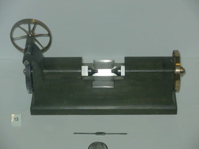

Eugene30/06/2015 09:19:26
131 forum posts
12 photos
"When Whitworth was working on The Standard Inch, he devised his "millionth machine" to compare different standard bars.
It 's accuracy depended on the feel of a scraped disc passing between the scraped surfaces of the sample bar and that of a facing piece. Whitworth claimed a skilled operator could indeed detect a difference of one millionth of an inch between "standards".
Link to the free E-book description **LINK**
Eug
Edited By Eugene Molloy on 30/06/2015 09:24:57

That is a great book. Thanks for the link. Downloaded no problems. Funny, I was just thinking about Mr Whitworth creating order out of chaos this afternoon after watching "Mad Max Fury Road" with all its steampunk inspired machinery and mechanisms.
Millionth of an inch by feel, that's pretty good eh. I reckon I can feel a half a thou in a big end bearing on a motorbike engine but have a ways to go yet to get to Mr Whitworth's standard. Feel was something the old time tradesmen prided themselves on. One little dodge on old fella taught me as an apprentice toolmaker was when feeling for tiny ridges or imperfections on the surface of a stamping die, particularly around radiuses, use the middle finger of your left hand (if you are right handed). It has less callous on it than the fingers of the right hand, or than the index finger of the left hand and so gives a more sensitive feel. One of those things I'm sure they don't teach in college today.
