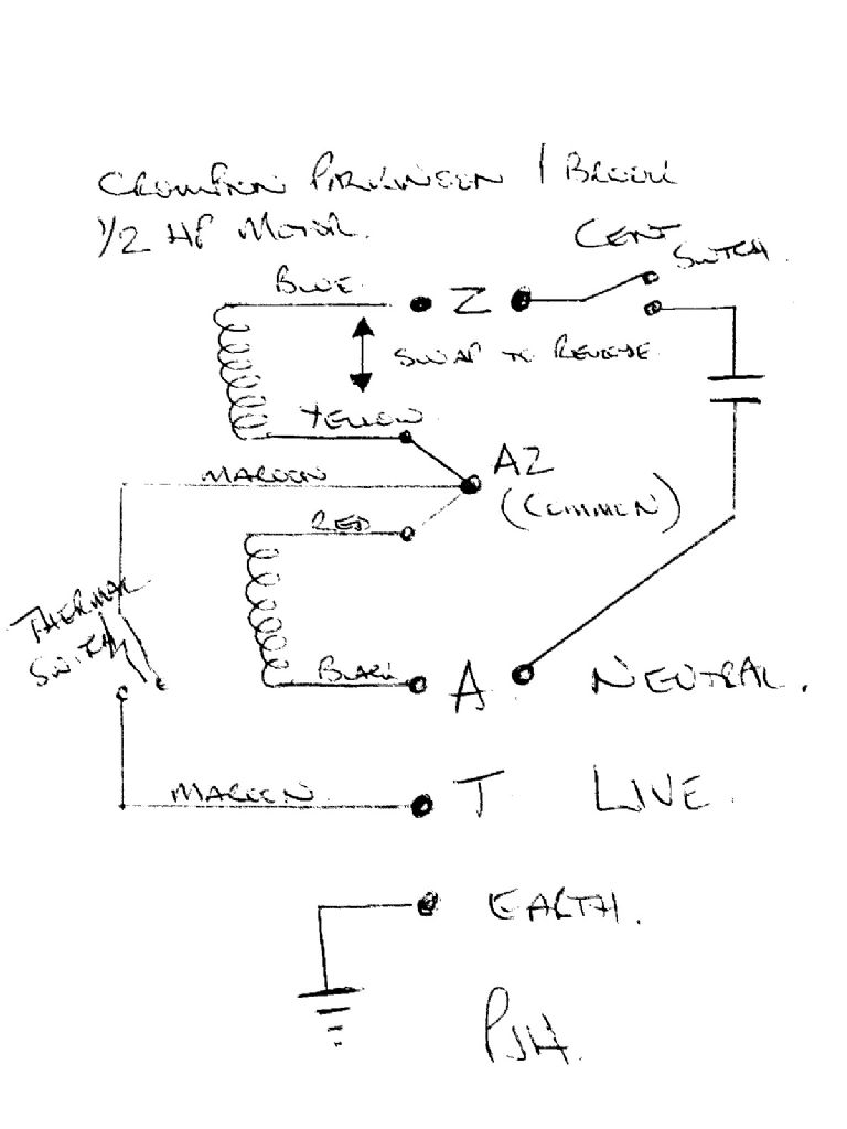

CotswoldsPhil17/08/2014 17:46:44
avatar
196 forum posts
112 photos
Hi Mark P,
I have today just swapped stators between two Crompton and Parkinson motors, one of which has an intermittent connection - it kicks when shocked, the other had worn bearings so making 1 good one out of two.
I'm looking at the wiring label inside the motor terminal box -
Z - Blue (or Yellow depending on rotation) motor wire + Green/Red from capacitor
AZ - Red + Maroon + Yellow (or Blue depending on rotation) motor wires
A - Black motor wire + Green/Red capacitor - This is the Neutral Connection
T - Maroon motor wire - This is the Live Connection
Don't forget the earth tucked in the corner of the connection box on the end case.
To change the direction of rotation - swap the Yellow and Blue wires on Z and AZ
My motors, are both working (one a lot faulty) each one in opposite directions, with the wiring shown above. I did have some difficulty confirming which was the blue wire (on AZ) because the colour has faded somewhat in the 40 odd years since manufacturer. In the end, I decided that the third wire was quite different from the Red and Maroon connected to the AZ terminal and must be the blue one.
Hope this might help
Regards
Phil H

CotswoldsPhil17/08/2014 20:04:37
avatar
196 forum posts
112 photos
Hi Mark and others,
I've worked up a hand-drawn schematic for the motors I've been working on, it's in my albums and reproduced here. The maroon wires are connecting a resettable overload cut-out on my motors. The centrifugal switch may be on the other side of the capacitor, it's also closed when stopped. Black and Red are run winding Yellow and Blue start winding. AZ is the common terminal.cpbrookmotorwiring.jpg
Hopefully it illuminates your problem. It's a bit manic spider but .....
Regards
Phil H
