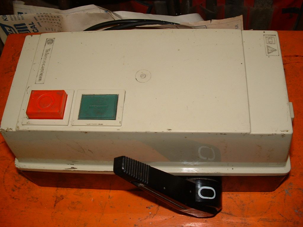

I have just removed my little mitsubishi inverter and 13a plug from the motor for my tool grinder and converted the motor to Star. I was about to put my 16A plug onto the lead when it suddenly occurred to me that I now have no on off switch and no fuse! I would be relying on switching the converter on and off to operate the machine. Which isn't any good.
As I have never used 3 phase 415V before only 240V 3 phase what do you generally do about a fuse, it's not in the plug anymore?

Emgee17/06/2021 19:49:52
2610 forum posts
312 photos
Posted by Buffer on 17/06/2021 17:11:32:
How have some of you done this and what sort of on off switches are you getting for your machines?
Thanks
Buffer
You could fit a DOL starter in the line to the grinder and rely on the protective device fitted within the converter or if the motor is fractional horse power you could use an mcb in an enclosure to provide switching and current overload protection.
I advertised here some months ago an ideal solution for you, a Telemecanique Fused switch with motor overload and stop/start buttons on the cover, IP65 rated. Still have 2 units left if you're interested.
Buffer17/06/2021 19:56:18
430 forum posts
171 photos
Clive
Thanks for the reply. Yes I have been using an Inverter and the grinder was switched by the inverter and the 13 A plug had a fuse but that has all gone now as I have a workshop 3 phase converter. It was only after I started to put the 16A 3 phase plug on the motor lead to the grinder that I realised there is now no fuse or on off switch! So I was wondering what people do about this.
Buffer17/06/2021 20:19:36
430 forum posts
171 photos
Emgee
Thanks I will keep that in mind. Can you PM me the details.
