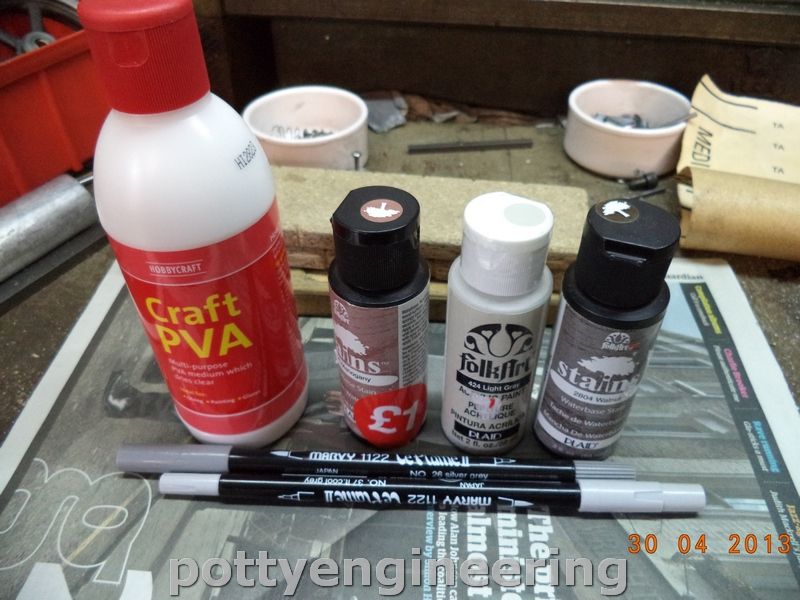

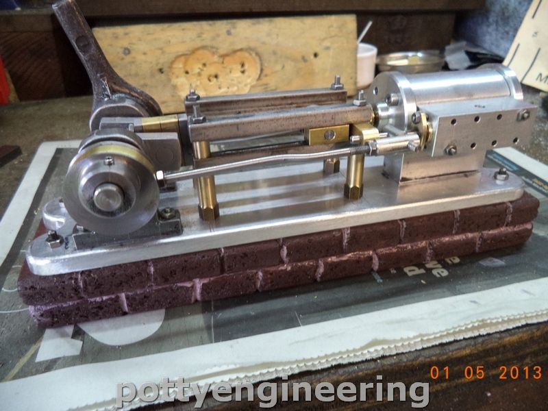

Whilst waiting delivery of some material to make the fly wheel I had a look round our local hobby craft shop they had a sale on so i pic this lot dsc00278.jpgIts some water based wood stain and some felt tip pens, the felt tip pens we're useless all dried up but the wood stain was ok, to mark the cement line i just mixed some of the wood stain with some white emulsion and put it on with a thin brush. Then to seal it I watered down some PVA and brushed it over. I don't think it looks too bad.dsc00282.jpg Just taken delivery of the fly wheel steel so its just some M2 studding I'm short of now Stew:------------ this site is playing up

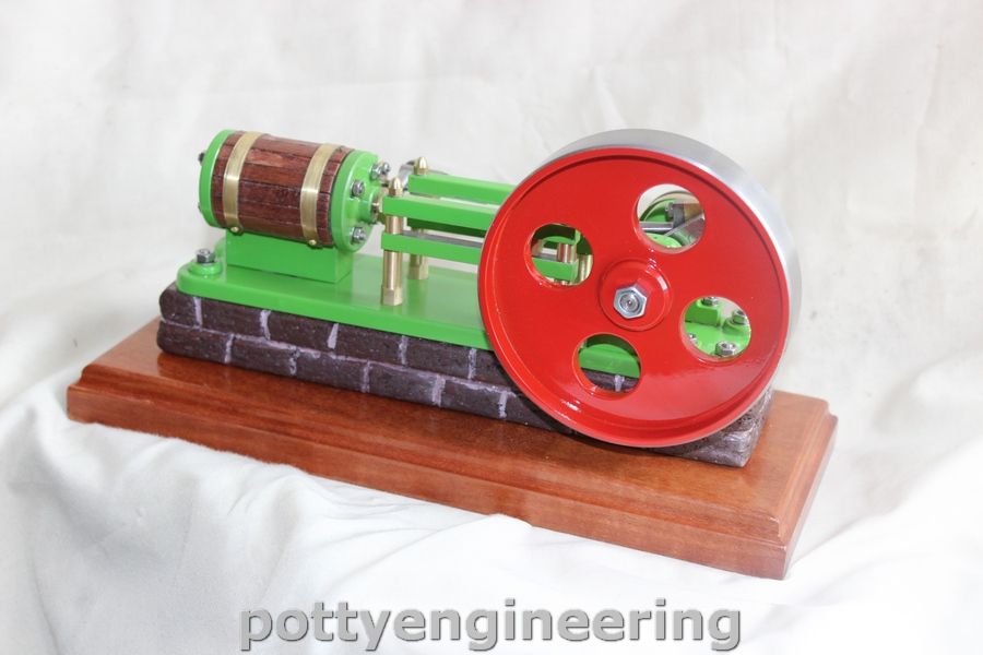

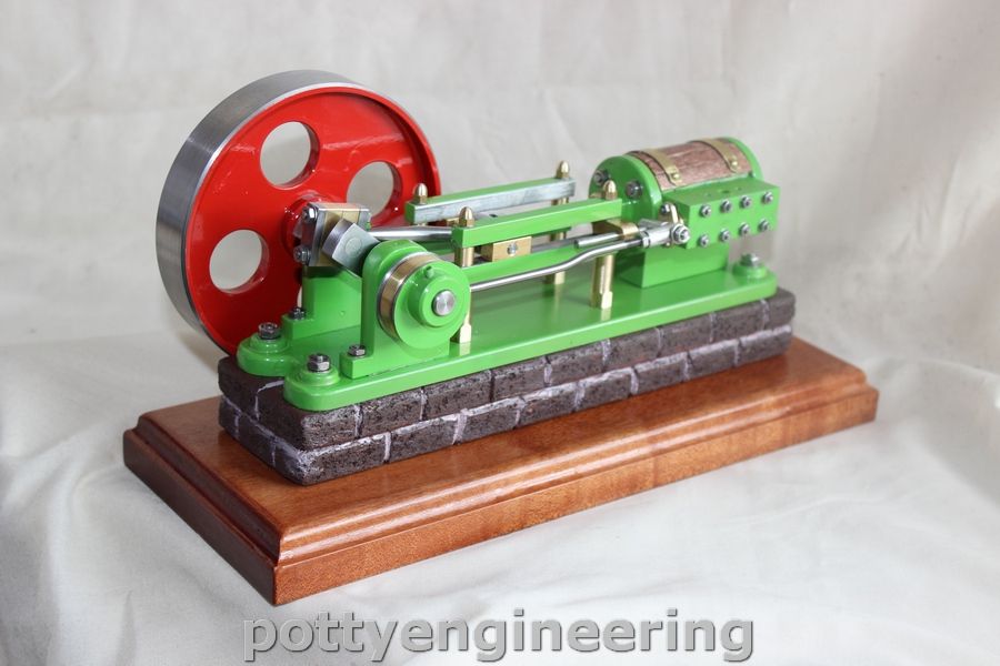

Stewart Hart24/05/2013 15:05:51
avatar
674 forum posts
357 photos
Well got the engine finished off her's a few glam shots img_0159.jpgimg_0156.jpgimg_0153.jpgStew
