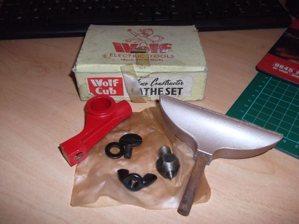

Mark Stevens 208/12/2013 20:59:36
1 forum posts
1 photos
Not wanting to Hijack the thread, I don't have the drill but I do have this :
I was given this over 20 years ago and have never used it. Any pointers on how to set it up would be very much appreciated.

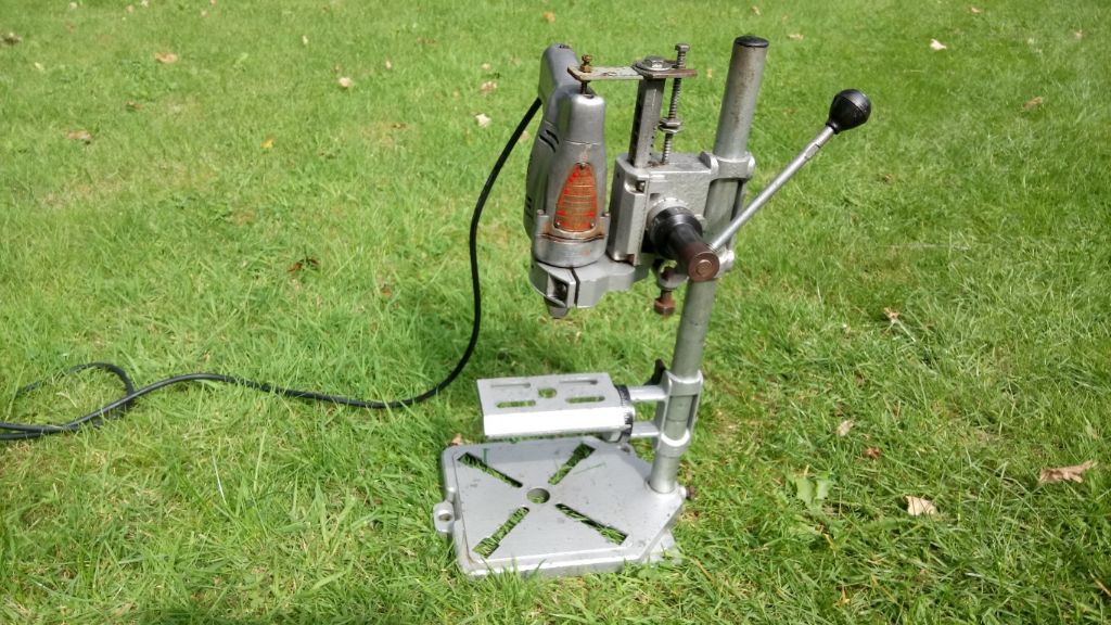

Clive Turnbull24/08/2017 23:27:29
8 forum posts
1 photos
I know this is an old thread but I have been looking for info on an old Wolf Cub drill Circa 1963. I decided to resurrect one I have had for years. I thought I would fit new mains lead and grease gears etc. Horrified to find only two wires in the lead. No earth at all and the drill is an all metal body! Does anyone know if this is the norm? Pictures here show double insulated but mine does not have that badge and the armature clearly states "Not to be used with double insulated models" Maybe I should earth the casing as I don't wish to light up at my age!!
Be pleased to hear any comments
Cheers

Enough!25/08/2017 01:57:21
1719 forum posts
1 photos
Posted by Clive Turnbull on 24/08/2017 23:27:29:
From my (somewhat hazy) recollection of that era, it seems to me that electric drill manufacturers in the UK (and probably elsewhere) (particularly Wolf) around that time were making a big thing about "Double-Insulated" and not needing an earth/ground.
Whether double-insulated drills from that period would still be considered safe - even in pristine condition - is something else.
Neil Wyatt25/08/2017 08:35:26
avatar
19226 forum posts
749 photos
86 articles
It looks like it has been incorrectly re-wired.
You should rewire it with an earth wire, and ideally have it insulation tested. Is there an earth terminal inside?
Clive Turnbull25/08/2017 09:26:57
8 forum posts
1 photos
Thanks chaps, I am taking your advice Neil There doesn't seem to be a terminal point as such but I have found a tapped hole near the grip so I will use that, I'm sure it will give me peace of mind. It looks well made s9 I'll bring it in to use again(standing well back with rubber gloves at first!!).
Cheers
Clive
Clive Turnbull25/08/2017 21:21:42
8 forum posts
1 photos
All done, not exactly state of the art! Working well anyway and earthed! Better than lying around in cobwebs and dust.
Thanks for input and advice.
