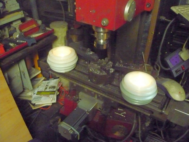

Sent to China to get some low wattage lights, according to the bumf they are very economical to run.
Parcel arrived today, unpacked it and fitted them to my X3.
Not very bright at all, might be economical to run but I feel someone is taking the pìss ??

HI John, Had a closer look at your photo and think that I know what the problem is. You have the lights pointing up towards the ceiling and they are not shining onto your work. Gives a nice mood atmospere to the workshop though. A couple of tee light candles would probably have the same effect. Nice one !

looks to me like you bought the wrong ones they look like t-lights to me
have a look at the start of this thread sombodys put a link on
i got 6 and i have'nt wired them up yet but i have got my sunglasses out ready

Seriously, I did buy some of these panel ones from China, just not got round to looking at them until last night.
I did post earlier I had sent for some. Don't know if they are the same as every one else's, come with three adaptors to replace bulb fittings ?
First of all tried it on a wall wart at 6 volts but no light which suprised me as these things are usually voltage sensitive if they don't have an inbuilt driver. So last night stuck it on a professional power supply.
Up to 7.5 volts they don't work, after 8 v then come on but not that bright, at 12v they are quite bright and throw off a decent light, power supply was reading 0.45 amps. 15v increased the light a fair amount and flat out at 22 volts it was drawing 1 amp but very, very bright.
No idea on the life at this voltage or heat given off but today I'm going to soak one at 15 volts and se how it last up.
Very impressed on what light they do throw out.
