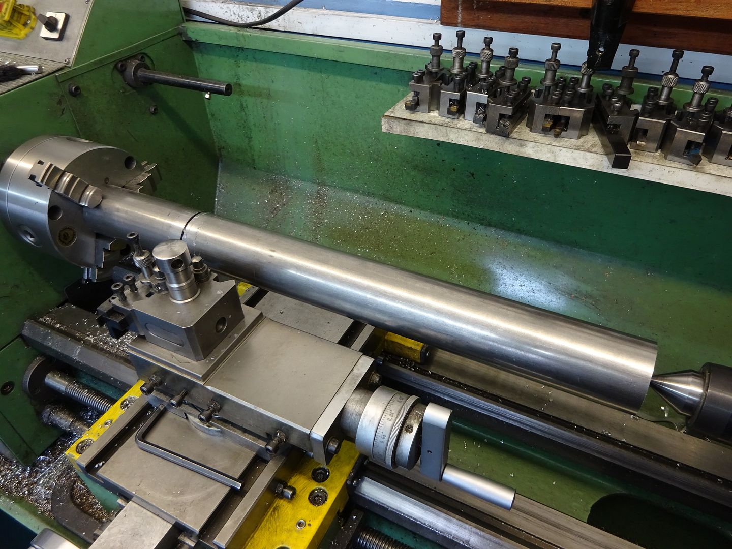

Like this, on a 3.5" diameter workpiece mounted on an homemade expanding mandrel:
Parting Front Wheel Hub

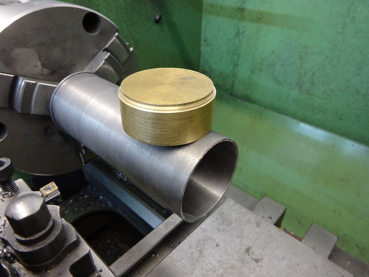

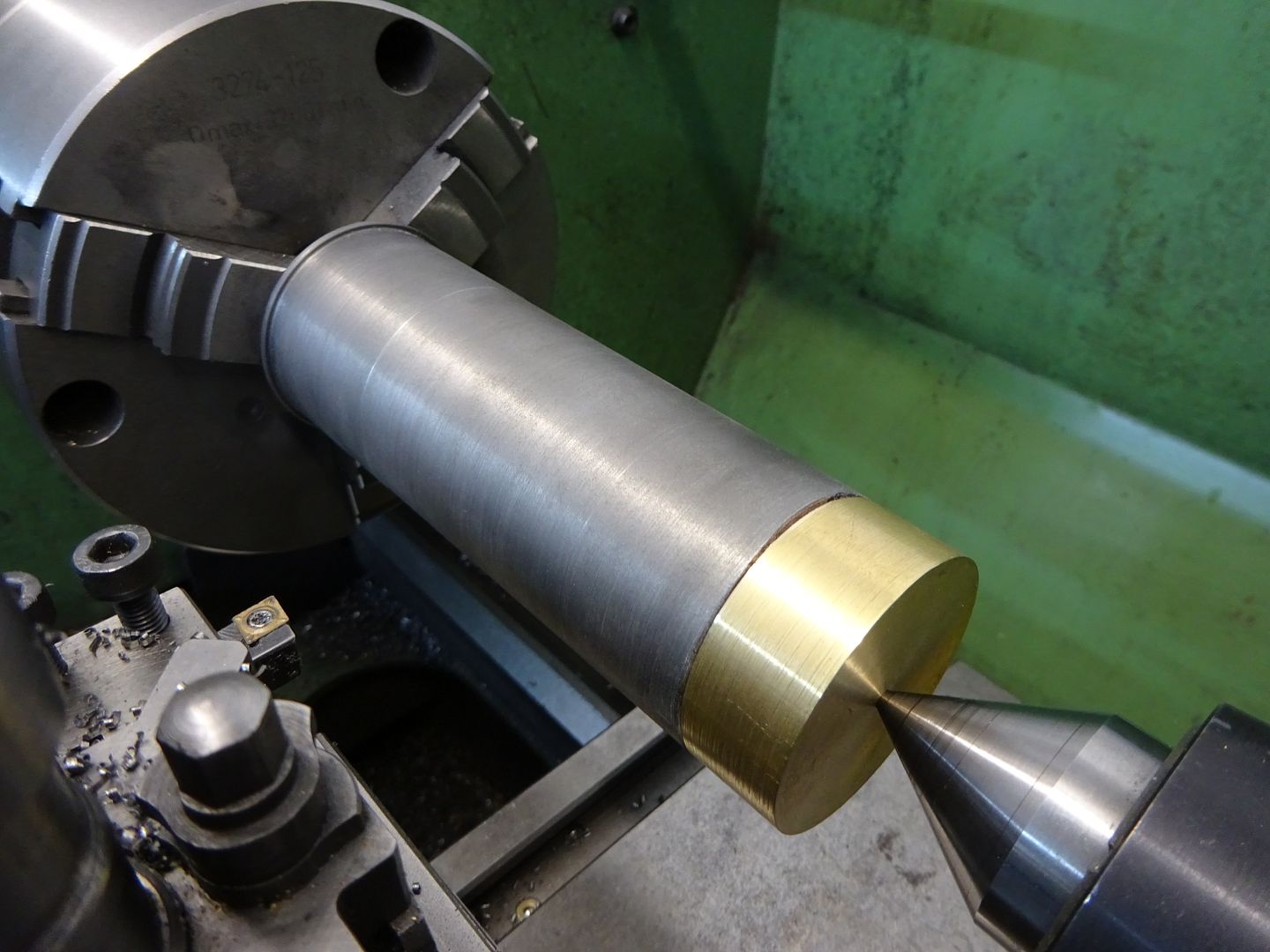

Have no steadyrest. Have no 4-chuck. Can't centre drill, as the 46mm piece is also 25mm hollow. I did start yesterday making a sort of bull-nose adapter cone for my live centre, but did not try using it yet, as it got late.
I guess I will use the bullnose anyway, even if only see the difference, but I think I need to go for the rear-post as default parting option anyway.
Mind you, the steady/centre/bullnose and the rear post address different problems. One addresses stability of the part, the other of the tool, so they may at times both be needed.

You can just make a stepped disc to fit into the hole and put a centre drilled hole into that
Also if teh work can be turned around so the groove is at the chuck end that will help
