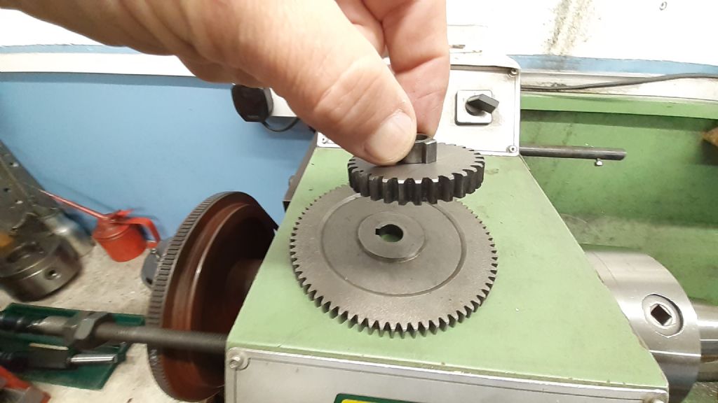

Image shows how having the correct thicker washer (black) on the lower pair of gear's stud moves them away from the pair above with the smaller washer. gap = difference in washer thickness
I don't know if the lathe came to you second hand without them or they have been missplaced but if you don't have them in place that will be why you have noisy gears

Sam they won't affect how the gear bush fit son the stud. The washers are 6mmID and only go onto the small M6 threaded spigot therefore moving the whole stud sideway
Not had a problem with mine coming loose and threads still holding after 12-13yrs,

Having separate washers allows you to swap them about depending on the gear train, some trains need the pair to one side some the other,
NDIY if you care to look at my images you will see the studs DO HAVE shoulders so there is a set length for the sintered bush to run on Stud is slightly longer than bush just like yours too..
They are more recessed "C" clip with what would act like an integral washer, so not as poor a design as your blind comment suggests. These washers just like yours can be slid off without loosening or removing anything so gears can be taken off while studs remain in position which sounds as good a design as yours
The spacer washers are thick washers, 1.5mm for the thin and 2.5mm for the thick not just cheap penny washers, not file tested them for hardness.

Few Photos for you Sam, my 280 but your 250 is basically the same.
Shot showing gaps created by the spacer washers between the large gears so they don't touch and ring
Same spacers keep gears away from Banjo
This one shows that with the washer on the 6mm spigot it bears against the studs shoulder so width for bush is constant and you WILL have room to fit the gears with "C clip" in place
Not sure why you had to ream out the 14mm holes, mine are all untouched and the bush a firm push fit so there is no wobble of gear on bush
There should also be a washer on the gearbox input inboard of the fixed keyed bush that has the shear pin through it
The two machined not pressed washers 1.5mm and 2.5mm thick, 25mm OD, 6mm ID
Setting gear positions with a strip of paper
Two images showing that sideways adjustment of banjo on it's pivot can at each extreme have the gears rubbing together or gears rubbing the banjo so set it about mid way
Lastly over riding the interlock this is what my gears run like first at 500rpm, then 1000rpm then with feed engaged. All motor noise to my ears

I have been out in the workshop, Put the washers in - The rightway round!!!
The gear wheels never fitted the shafts they were so undersized it was a joke. I drilled with a drill bit borrowed from an engineering shop that was very slightly under 14mm, then reamed to get them to fit. I even had to file 2 of the key ways.
I used the paper to set up. When done the drive forced the arm with the change wheels out of mesh & it means I have to push it up very hard & really tighten it beyond what one might expect. But I cannot see where there is any stiffness. The slide is not overly stiff on the bed,
As for noise - Still much noiser than yours, but bearable if I stick below 650 RPM above that & the arm jumps out of gear. Only leave it set up if I intend to use it otherwise I will just disengage.Mine is nearly as noisy as yours without the change wheels engaged.
I did not grease the wheels but used chainsaw oil as it is sticky & does not fly out. I also use it as a cutting fluid & it works OK & is cheap.
So I will see how it goes
