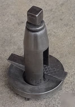

brian jones 1107/07/2021 17:08:49
347 forum posts
62 photos
A real mans tool post Rocker or Lantern? Did Myford ever have one of these?

ega07/07/2021 17:51:10
2805 forum posts
219 photos
The early Myford rear tool post employed the rocker principle.
AFAIK, they never offered a lantern front tool post - best left to vintage American machines.
Martin Kyte07/07/2021 18:08:18
avatar
3445 forum posts
62 photos
That's what the Myford boat holders do. They were a form of quick set in not needing shims for tool hight.

Dave Halford08/07/2021 12:29:51
2536 forum posts
24 photos
Posted by brian jones 11 on 07/07/2021 17:08:49:
good thinking
Edited By brian jones 11 on 07/07/2021 17:19:56
With those all you need to do is change the base for a flat ring to give you centre height on your insert tool and you'll never have to check insert centre height ever again even if you swap from straight to left or right handed holder in the set.
The boat or rocker requires constant checking every time you move it.
If you use Armstrong holders the same applies for HSS till you sharpen them.
Sometimes the old junk is better than the new junk, depending on how much outlay you have invested in the new junk
Howard Lewis08/07/2021 13:09:14
7227 forum posts
21 photos
Give me a proper 4 way toolpost every time. (These earlier things were the best that they could manage at the time )
Boat / Rocker posts don't keep the rake angle constant as centre height is maintained.
The need for greater rigidity and speed brought about the 4 way and the QCTP..
Guess what Industry uses
Their QCTPs are rigid, designed for heavy work, and quick tool changes.
Howard
