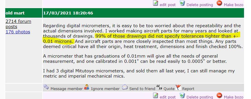

Regarding digital micrometers, it is easy to be too worried about the repeatability and the actual dimensions involved. I worked making aircraft parts for many years and looked at thousands of drawings. 99% of those drawings did not specify tolerances tighter than +- 0.01 microns. And aircraft parts are more closely inspected than most things. Any parts deemed critical have all their origin, heat treatment, dimensions and finish checked 100%.
A micrometer that has graduations of 0.01mm will give all the needs of general measurement, and one calibrated in 0.001" can be read easily to 0.0005" or better.
I had 3 digital Mitutoyo micrometers, and sold them all last year, I can still manage my metric and imperial mechanical mics.

Posted by old mart on 17/03/2021 18:20:46:
99% of those drawings did not specify tolerances tighter than +- 0.01 microns. […]
I would confidently presume that 100% of them did not specify tolerances tighter than +- 0.01 microns.
I work [O.K. I play] a lot with microscopes, and 0.01 microns is very small indeed !
Would it be reasonable to guess that you meant +/- 0.01 mm [i.e. +/- 10 microns] ?

I thought I had produced another of my typo's, but looking at my post, it says 0.01mm.  Now I see that the size was down twice, of course I meant 0.01mm both times.
Mitutoyo make a digital micrometer that measures down to 0.0001mm, seems rather difficult to ever get the same reading twice with one of those.
