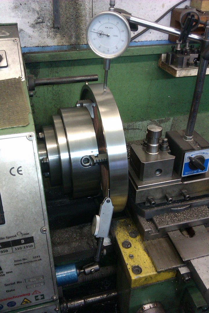

Posted by Robin Graham on 10/08/2020 00:02:56:
Good to hear that 0.03mm isn't too bad given that it's a Chinese lathe/chuck. The chap I'm working with has suggested referencing off the chuck face using parallels, which is another avenue to explore. I guess that's going to be more accurate than referencing from the flats on the jaws.
Why take a guess, put a Dti on the chuck face and see what it runs like, no point in using that if it's too far off, same as knocking it back against the chuck jaws if they are off.
Also once you pull the parallels out or before turning if leaving them safely secured ion place put a dit on the back face of the work to check runout, a bit like this but you will need the rear one on the cross slide so you can move it out the way of the jaws
Thanks for replies. I understand that milling is the 'natural' technique for making the ends of a bar parallel, but for various reasons it's not an option here.
Several good ideas for doing it on the lathe though - I'll experiment. I think Martin's / Gray's suggestions of turning between centres will be the first experiment - it's a technique I've never used, so it'll be fun and seems to be guaranteed to work - provided the lathe's set up correctly of course!
Robin
Posting on your ‘faceplate’ thread this morning reminded me to mention this ...
For best results when turning between centres, you will [obviously ?] need to switch the workpiece end-for-end, rather than changing tools and saddle position. ... You want both faces to end-up either flat or very slightly concave.
This is true. yes
I'll add that for supreme accuracy, be sure that the heastock centre is running true, and if it isn't, then give it a skim in position to make it so.
Martin.
