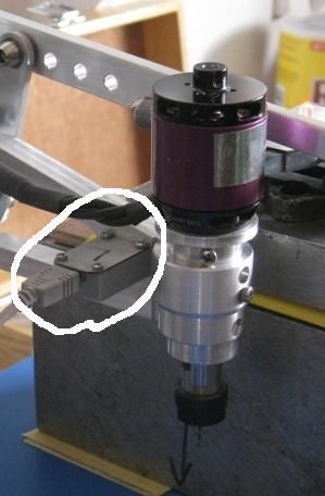

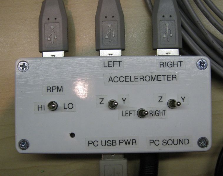

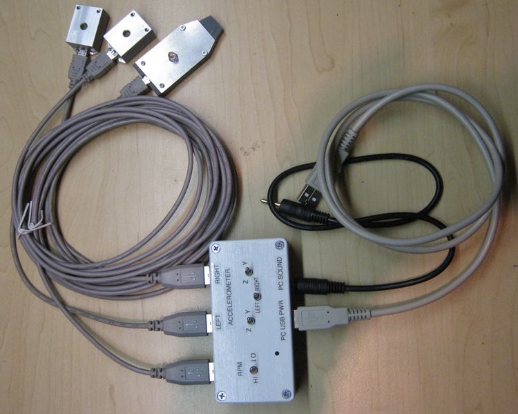

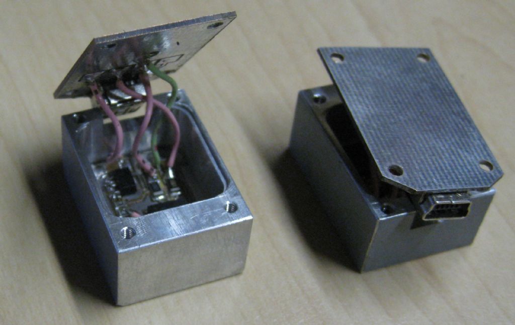

Can't find my circa 2016 post on the vibration analyzer/balancer I built up ....Anyway, used software from Miklos T Koncz , a Hungarian. Built up the accelerometer sensors using ( now a bit old..) Free scale MMA7260 3 axis analogue output devices, into the laptop sound card, with an optical rotation position sensors.
Works very well indeed - used it to balance spindles etc, up to 25K rpm.
Might have a go and instrument the lathe...
Accelerometer modules
Sensor selection control box
Balancing a 20Krpm spindle on a sensitive drill press.
Red arrow is the balancing 'weight' - a small strip off adhesive aluminium tape. White circle is rpm and position center.
Accelerometer super-glued to support arm to measure lateral acceleration.
