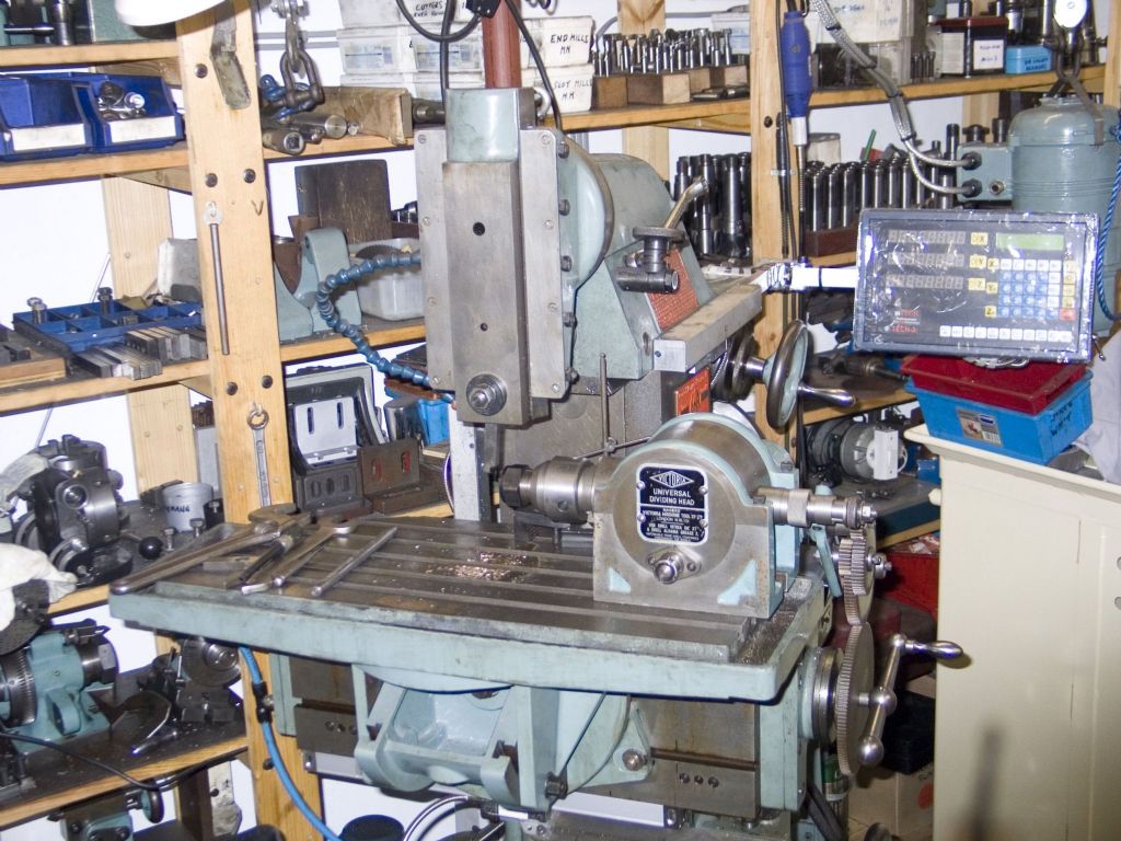

You have probably already found some photo's of my Alexander, but here is one for some inspiration. The machine was my late fathers and he rigged it up to use for gear cutting using the Sunderland principle.
A few more in my albums

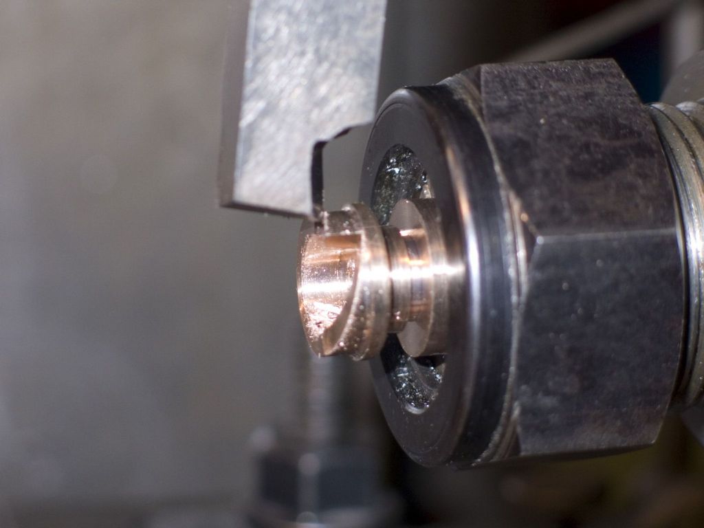

This is one of my set ups for shaping a 3 lobe spiral claw coupling for the barring engine on Agnes.
Phil
