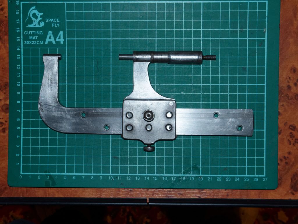

There are varieties available which don't have a 4" thimble.
This Starrett works as a 0-1" through to a 5"-6", so almost fits the description.
0-6 Starrett Micrometer.
It's getting a bit tired now but is accurate at both ends, but the 2"-3" and 3"-4" misread by one and two thou respectively.
I don't know if it was originally supplied with a set of reference bars.
See also THIS LINK
Bill
