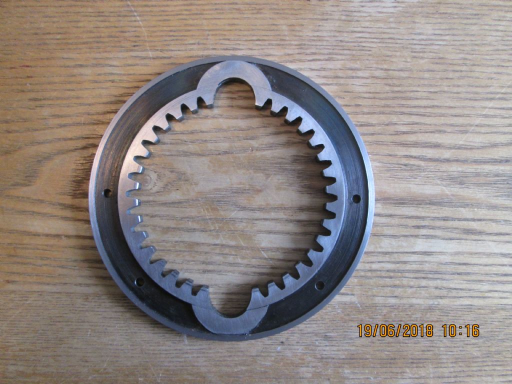

Mick B116/06/2018 17:49:32
2444 forum posts
139 photos
I couldn't get the flux-cored soft solder I use on electrics to take properly, so I tried silver solder.
That worked, but I've got a couple of stray blobs oozed out. They won't (AFAIK) interfere with owt, but they look untidy. blush
Think I'm gonna hafta Dremel out as much as I can with those little rotary diamond file affairs, then finish off with the point of a Swiss file ground like a watchmaker's turning tool.
Unless anybody would please tell me a better way? angel
Mick B119/06/2018 11:26:03
2444 forum posts
139 photos
Well, the Dremel (actually Rotacraft) didn't really work - there was too much risk of carving into the steel underneath the silver solder - but I found a titchy little parting tool I'd ground for titanium earings I was turning on the little Sieg C0.
So I mounted that in the Warco pointing at the chuck, gripped the inner gear ring on the outside jaws, set the tool to kiss the recessed face and rotated the chuck by hand until the reinforce hit the tool. It peeled off a strip of silver solder. I had to back off a bit on the thickest bit of the blob and do it a few thou at a time, and of course it left a tiny triangle untouched where the flat-faced tool couldn't reach, but maybe 20 minutes' work cleaned off almost all the blobs. Then I blacked the part with gun-blue creme, washed it and emeried the o/d and front face.
Maybe my standards are low, but I think that's now OK. I wish I could get rid of the joint line on the lower reinforce, but I'm not yet sure I care enough to take the trouble - I thought about filling it with soft solder but there's probably some solder-hostile crud in there by now so I don't know how easy - or risk-prone - that might be.
Maybe I'm making a meal of stuff some of you probably think is nursery-slope work... laugh
JasonB19/06/2018 13:25:17
avatar
25215 forum posts
3105 photos
1 articles
Looks good to me, you can always leave the crank arm over that joint when the engine is on displaywink 2. Even if it had soldered up a bit tighter the silver solder can tarnish over time and leave a black tell tale.
Mick B120/06/2018 06:53:01
2444 forum posts
139 photos
Posted by JasonB on 19/06/2018 13:25:17:
Thanks, but sadly I can't - the crank arm's behind the hypocycloidal gear set, and the piston rod bigend only goes straight up and down between the inner radii of the reinforces. Anything I did to widen it would probably just look as if it was there to hide summat... blush
JasonB20/06/2018 07:30:59
avatar
25215 forum posts
3105 photos
1 articles
Just had another look at Anthony's design and yes it can't be hidden. Short of cutting your own from a slice of CI bar there is not that much that can be done, the internal gears are not that hard to cut.
