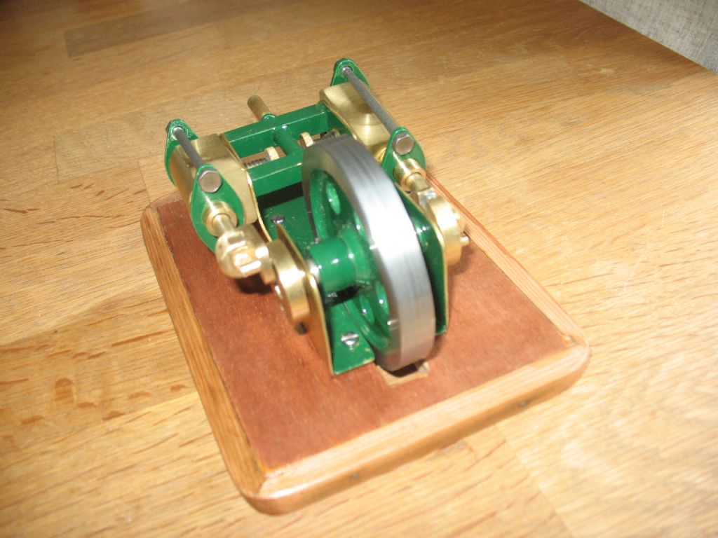

We all get something different from our hobbies, for me its the satisfaction of creating something from nothing or salvaging something that everyone gave up on and turning it into something that makes people smile. I got interested in steam a few months back and decided to make an engine similar to the tubalcain twin cylinder/double action/oscillating engine, yes, its a mouthful haha. I bought absolutely nothing for this engine, everything came from my scrap box and what was lying around. I made a few changes to the design and appearance, I think it turned out well and it runs a treat ! here's a pic........img_0887.jpg
