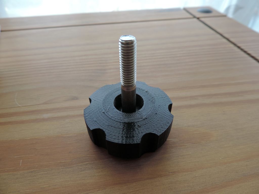

Well that turned out even better than I hoped!
Oversize by about .25mm in X and Y, probably largely due to filament ooze, thickness would be dead on 19mm, except I couldn't get the brim (extra 0.4mm) to peel off!
Edited By Neil Wyatt on 20/04/2017 14:11:26
