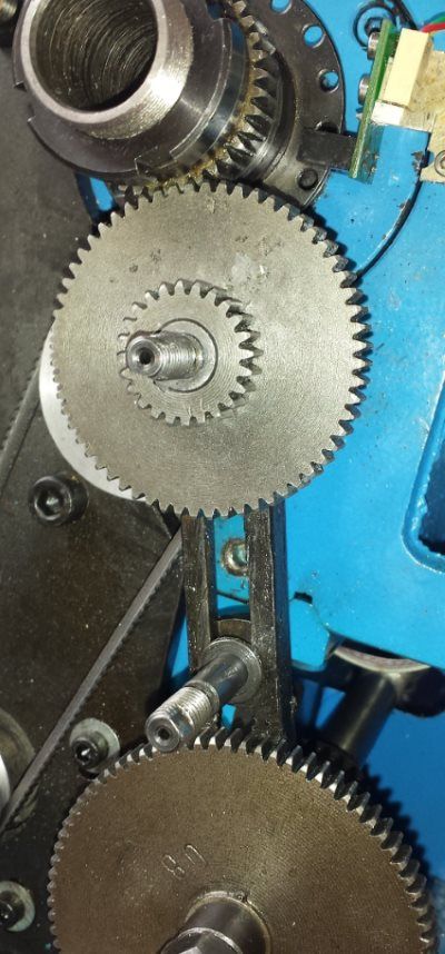

09/07/2016 14:24:06
This is the 60 tooth fitted in the uppermost position, i had to grind the nut to move it this high on the bar.
Swinging the arm over, and it only just makes it, It will almost swing under the spindle gear but not quite.
I tried the 1.75 thread and it came out way off. I cannot remember what it actually cut. I tried several calculators and they were off. But i did suss it out, it seems a failed hard drive and old age has crept up on me and i have forgotten what worked.
Thanks for putting up with me.
09/07/2016 02:29:50
Sorry guys, i got distracted with other projects but now need to rattle my brain on this one.
I have a chart of what gears to use but its useless, the ones in orange will not physically fit onto the bar or in the space between the leadscrew gear and the top of the bar the gears attach to.
There are probably more that do not work, but not had a chance to try them yet. I think the 1.75 comes out wrong also?
What am I missing? Someone please knock some sense into me Thanks.
A 60tooth gear in the A position only just reaches the spindle gear, i had to grind a small chamfer in the locking nuts. Anything less will not reach the 40tooth spindle gear.
Manual must be for an old model where they changed the design and possibly even the leadscrew pitch?
Thanks
Edited By Dave Smith the 16th on 09/07/2016 02:32:54

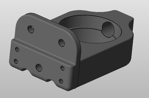

07/07/2016 20:24:37
Was not sure where to post this?
Having recently bought the SX2p Mill from ARC one thing i didn't like was having to get the little tool to lock the spindle. Seen some ideas on the net, but mostly they are for the gear driven ones where they have a plunger on the top.
Whillst doing the design in Freecad i thought why not include a rev counter also.
The first thing i did to the mill was remove the plastic shield, ideally i wanted to use those. I came up with this..
What do you think?
