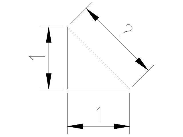

SillyOldDuffer06/11/2016 20:46:13
10668 forum posts
2415 photos
Posted by Clive Foster on 06/11/2016 19:17:36:
Fractions are exact by design.
Clive.
To their amazement the ancient Greeks came unstuck with that notion when they tried to solve this simple example. Given a right-angled triangle with two sides of length 1, what is the length of the diagonal expressed as a fraction?
Fractions are an excellent tool but they also have serious limitations. I'm not suggesting decimals are perfect but they are considerably more general.
