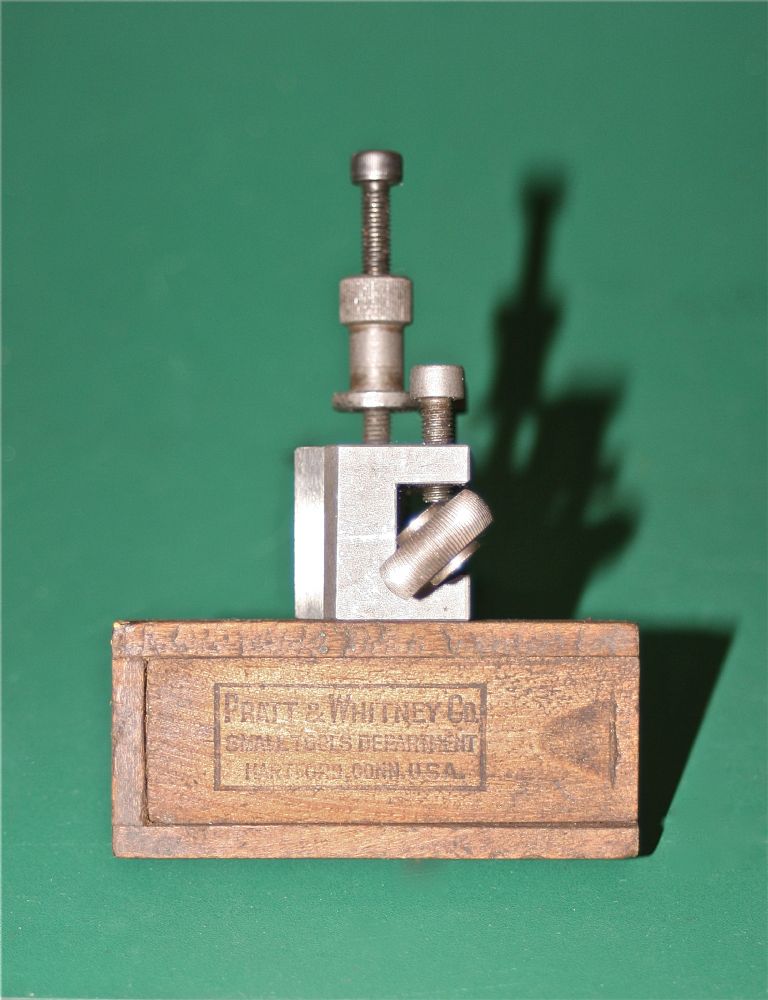

With reference to rope edge knurling, in 2012 I rebuilt a very old Stuart No. 1. At some point in its life, it had been fitted with a shaft governor. The two "knobs"| which adjust and lock the return spring tension are rope edge knurled, first picture, and I wanted to replicate this on a rod length adjuster, a stop valve hand wheel, and a near copy of a Stuart lubricator. I succeeded fairly well using the knurling tool shown. It has a convex face. I mounted it at 45 degrees in a boring tool holder. Having prepared the blank wheel, I engaged back gear and presented the knurl to the work. Once it had been round a couple of times, I moved the tool sideways to the right. You could hear the load come off the gears, and as this happened I fed the tool in to restore the sound. I progressed sideways until I thought it had cut far enough down the side. I then moved the tool the other way, retracting the tool as I went. On reaching the centre again, I continued to the left , feeding it in again while listening to the sound. Doing it all in one go without stopping, sounds like juggling, but I was surprised how quickly I got the feel of it. If prefered you can stop having gone one way, then retract the toll, return to the centre of the work, and carefully reengage the knurl to do the other side. The results are in the pictures. On the rod length adjuster, only the adjust screw is rope edged, the small locking screws are straight using the same knurling wheel. Not my best efforts at photography, sorry. I don't know how far down the sides the knurling came on old equipment, but I was able to duplicate that which was on the engine already. I hope this may be of some help
Maurice Coxold knurling.jpgknurl 3.jpgknurl 2.jpgknurl 1.jpgnew knurl 1.jpgnew knurl 2.jpg
