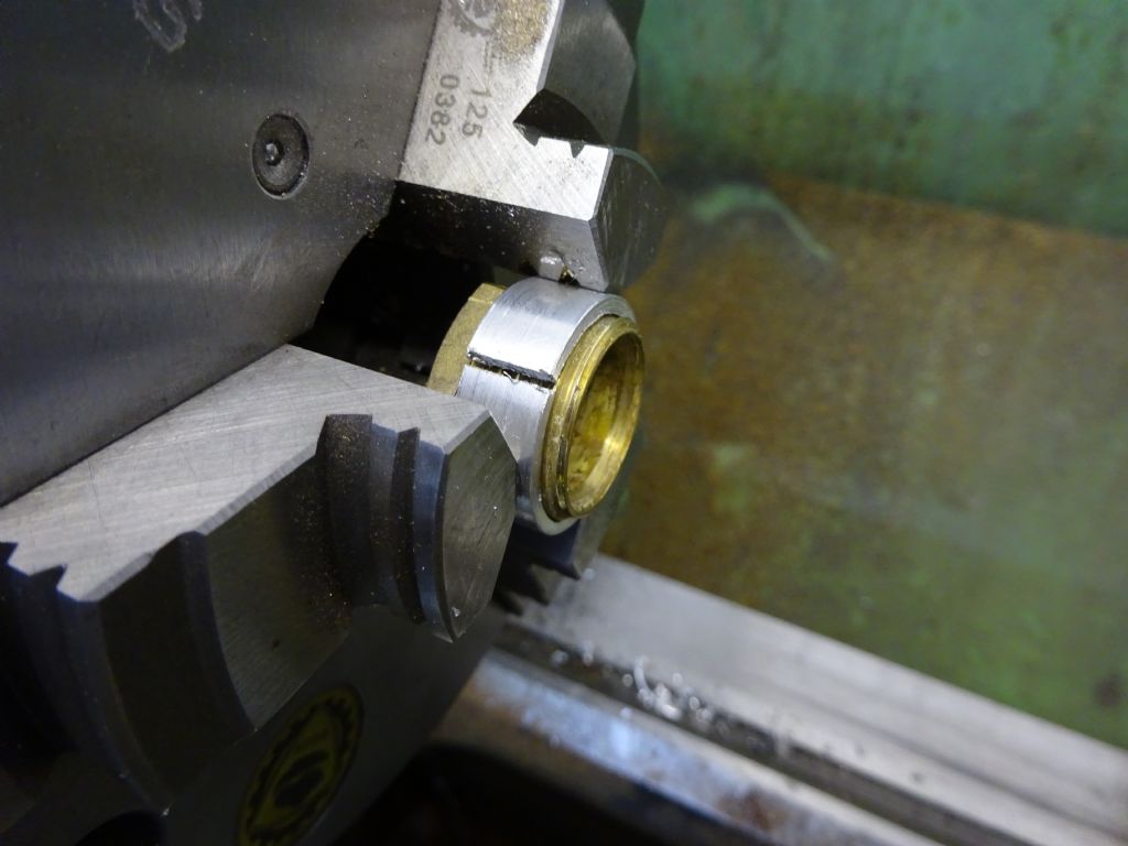

What I want to do is put a spring recess 10mm wide by 1mm deep in the plug that screws down on the spring.
I have the 2 flute end mill to do the job. Just looking for a quick way to center the plug in the chuck or whatever.
Have a good few to do!!!
Hi Jim,
Is this what you are trying to produce? If so, how deep in mm is the head that needs to be gripped?
Ta,
Yes. This is what I want to do. The head of the plug is 4mm X 25mm and the treaded part is 15mm X 20mm long

Jim to return to your original post - have you got any nuts for the thread (is it a standard thread eg M20 - do you know what the thread is?)

The grip length of an ER40 collet is too long really for holding 4mm x 25mm accurately. It's the main problem with this style of collet.
If I had a lot to do I suspect I would make something to hold them first. That could simply be a recess in something that was a snug fit using grub screw to hold them in place but you may have to avoid marking them so the screws would need some thought. Soft solder ends maybe. Or some steel plate on a surface plate. Drill a hole through it, slit into the hole from one edge, drill and tap a hole through the edge to clamp it up. Mount on the lathe face plate with the clamp screw tightened a touch and then machine the recess for the screw heads.
Soft jaws are another option and maybe normal a normal 3 jaw chuck with the jaws reversed. That way you will have a square on face to press the head up against. If you rotate the work by hand just as the jaws close on it things generally will run as accurately as the chuck does. There is a bit of a knack to doing that though. A small chuck will do this sort of thing easily. Big ones too if the part is big enough. It may be feasible to machine up a split ring if that's the case. You may find that you can't get the part out if you do that though.
Rotagrip stock soft jaws but be prepared to spend a while fitting them to the chuck by hand with a file. I think they are deliberately made a touch over size. Getting them to a really good fit usually takes me 1/2 hr or so being very careful to find out what aspect needs relieving. They only need thou's removing as well.

It is a a standard 1.5. The problem I'm having is griping the 4mm head of the plug and getting it to turn true.

Posted by Jim O'Connell 1 on 05/09/2016 10:39:31:
That's because you're addressing the wrong problem. wink 2
As Frances says you need to make a jig to clamp on the thread. Either use a nut or make a threaded bush. Ideally the nut/bush would be split so when you tighten the chuck or collet the thread is gripped firmly. I can't imagine that it is critical that the recess is exactly centred; a few thou out isn't going to matter.

As the threaded part is 15mm dia I think you might be able to find a bit of copper plumbing pipe, cut some bits to length, slit lengthways, and use more than one layer to give you enough thickness to enable the thread to be gripped in your chuck without the head fouling.

The split bush is probably the easiers option as Andrews says. I think a plain bore would give enough grip for what you want to do if you use a soft metal such as aluminium.
Assuming your plug looks a bit like the cap on the left then find an odd bar end that is just over the dia or A/F of the head, bore it out until the plug just slips in and face off to length of plug or a bit less. Take it out of the lathe and put a saw cut lengthways.
Now slip the plug into the bush
And you now have a longer length to hold the plug by which should help keep it from being held crooked and it will also be concentric to the thread regardless of head shape. Also minimum sticking out of the chuck so it won't get snagged by the tool.
