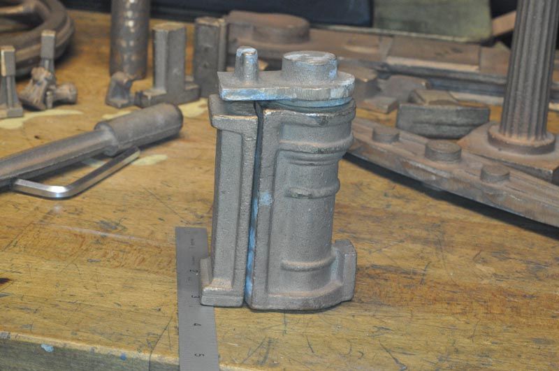

Well, I had the drawings; now I've got the castings - from ebay

John Purdy25/03/2016 20:21:24
avatar
431 forum posts
252 photos
Rod
It looks like your castings are the same as mine were except that your base appears to be CI were as mine is Ali.
If your castings are the same vintage as mine one thing you might want to check is the top cyl. cover. I found that the distance between the piston rod and valve rod gland bosses was about 3/16" too short. So I cut it in half just shy of the valve rod boss and silver soldered a piece of steel ~3/16" wide between the two pieces to give the required 1" dimension between the piston rod and valve rod. See pics.

Roderick Jenkins14/04/2016 12:13:48
avatar
2376 forum posts
800 photos
John,
I'm not really familiar enough with this engine at present to fully understand the bits you are referring to. Is this the part you mean?
Thanks for the heads up on the cylinder cover, mine looks OK.
Even my baseplate is bronze - I suspect the scrap value may be more than I paid for the castings surprise
Rod
John Purdy14/04/2016 20:16:27
avatar
431 forum posts
252 photos
Rod
Yes that's part of it. What I would like to know is does the 1/8" pin on the valve cross rod that the eccentric rod valve end and latching lever fit on to have a groove in it for the latching lever to fit into. It appears from your drawing that it must as the latching lever has a 3/32" round ended slot in it, whereas my drawing shows it flat.
