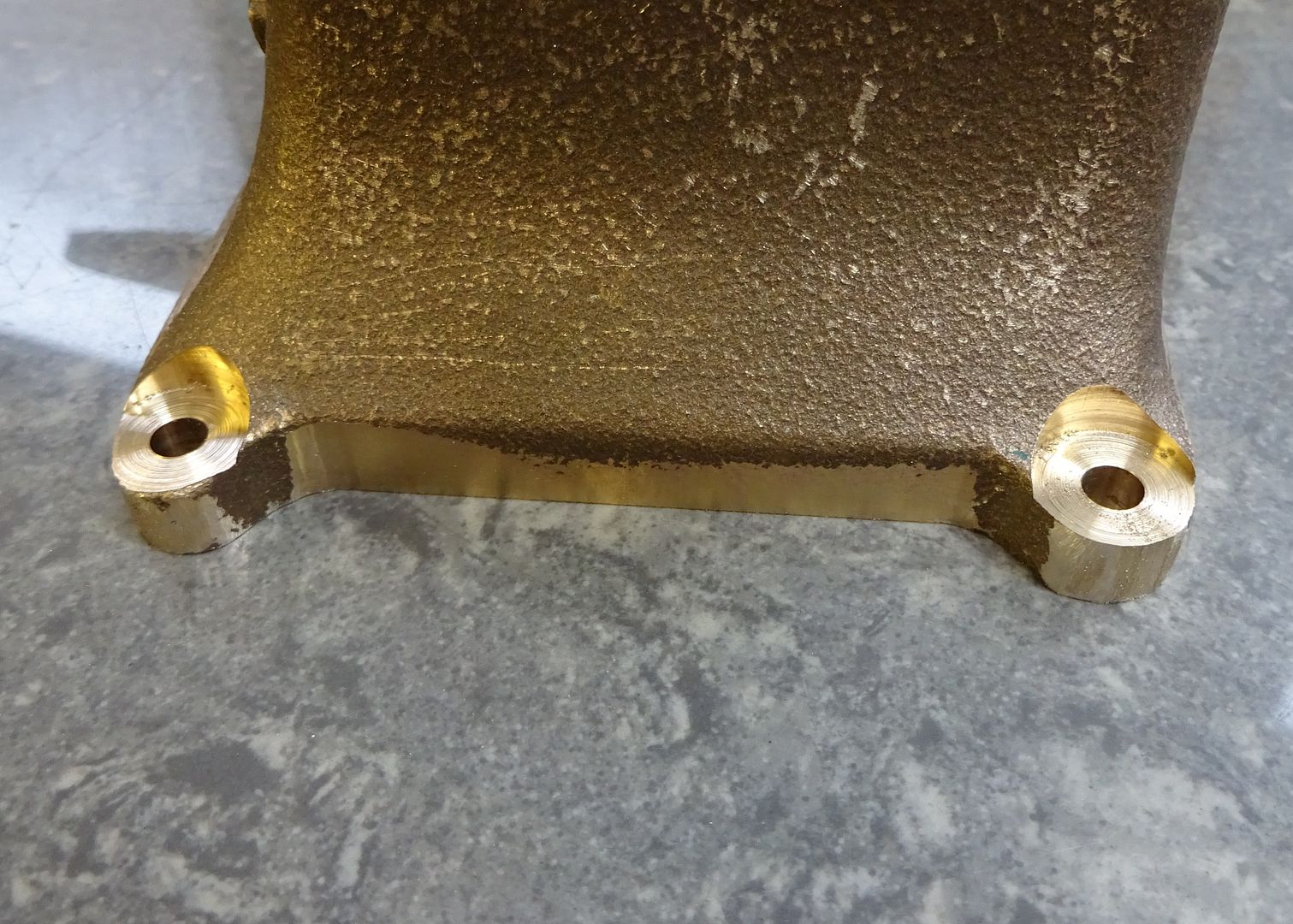

So I spent a bit of time over the weekend making a few tools that I will need. I need at some point to drill and face off the standard. This is quite close to other parts of the casting so I would not be able to do it with standard bits of kit. I therefore turned some scrap drilled and reamed the ends to accept such. These were locktited in as they will not be required to be a long lasting service item.
The milling bit and drill were held in the tailstock to ensure they went in reasonably straight.
This is what they are needed for. :-
Also made some T nuts to take some M8 fixings that will be required later. (the ones I already have take M10)
The fly wheel is 5in dia (or hopefully will be wink) In order to mount it on the faceplate I would have to drill extra tapped holes into the hub of the D1-3 section. It's not the best of quality faceplates anyway and I am aware that before too long and many projects it would end up looking like the backstop wall after a Mafia firing squad had been active. So on the recommendation of another member I purchased a 20mm thick piece of aluminium. This I will drill and tap onto the plate. (and hopefully stiffen it up a bit) I can then drill and tap fixing holes when ever and where ever I want in the best position for many years to come. Well I hope for many years anyway the price of the damn stuff. sadlaugh

You may find that milling cutter gets a bit lively when you try to use it that far out of the chuck, what you really need to make is a reverse spot facer, easily filed up from a bit of Silver steel, hardened and then clamped onto your drill bit.
Can you not use the 4-jaw to hold the flywheel by the inside of the rim? You can usually fit a six spoke in OK

That is an inovative way of doing it by reversing the casting. I would never have thought of that. I have though done it before I posted that image and your response.
I was mindful of possible chatter but I just had to spot face not cut into a fillet of the casting as you have done. It went OK, but if I had material at an angle to remove I would I think have had problems. Your method is going into filing cabinet in my bonce for future use though.
I did consider the 4 jaw for the fly wheel as you suggest, but I think I will be more confident with the faceplate method.
Thanks, Nick

Same cutter can be used the right way round fixed to an extended drill or bit of rod so you have a spigot that locates in the hole much like an off the shelf counterbore.
I'd also slip a bit of MDF or ply between your ali plate and the flywheel, that way you can machine right across the rim without scoring that nice shiny new plate

Anyway. Decided to finish the main bearings. So they were mounted onto the milling table and drilled out in stages.
I did ream to final size but forgot to photograph.
Then onto machining the flywheel. I decided to use the faceplate method.
I drilled and tapped some holes to fix the flywheel and mounted it with some ali spacers behind.
There was an inconsiderate blow hole that reared it's ugly head while facing one of the sides. sad So I had to machine a bit more off than I would have liked. There is still a little bit visible though Grrrrrrr.! But I suppose I can live with that.
