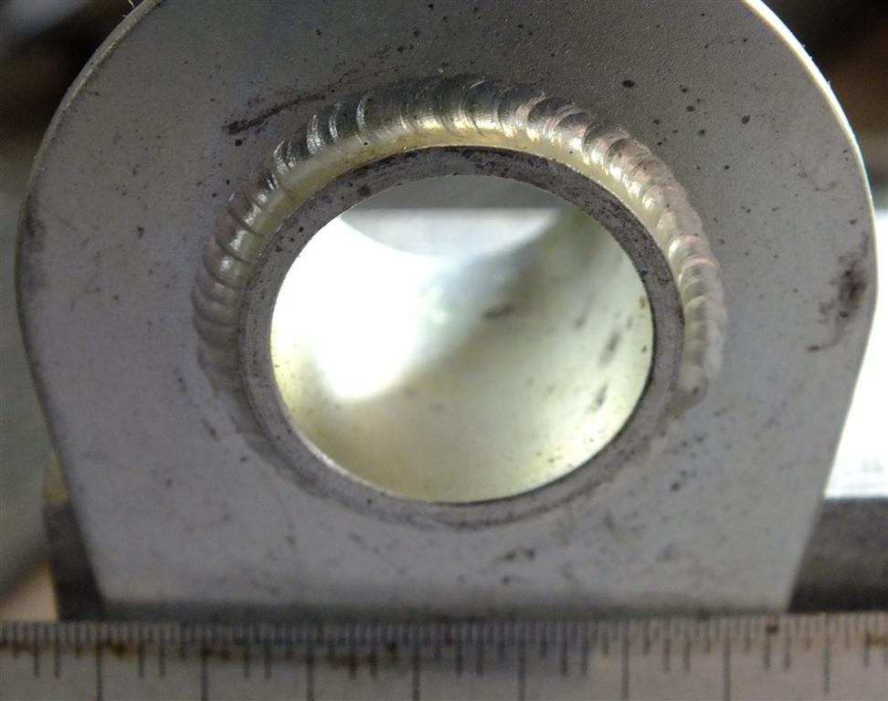

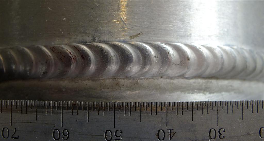

Well I asked my girlfriend to show a couple of examples of her welding but she's too shy so I'll do it for her.
Alloy pipe to flange.
Steel weldment.
Both a bit dirty from being stood around. She told me to post them as my work just to upset you lads.
Dunno about that but sure upsets me.................
Edited By John Stevenson on 28/04/2015 22:34:25

John,
BH I would give up. It's the best I've seen!
I thought my O/A was good, but compared with this it was third rate.
Must be the feminine touch.
If that was my welding I would want everyone to know and drool.
