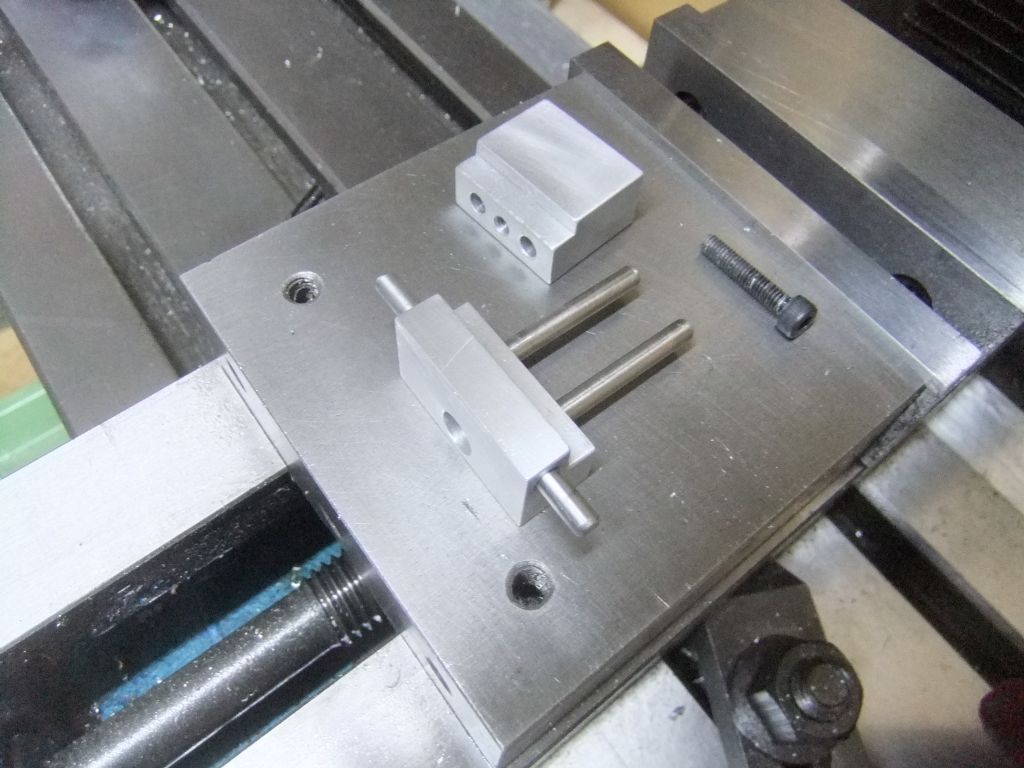

Been meaning to make a small vice stop for those odd jobs to save some of the set up time. I used some offcuts of ali from the rounds I cut up for the Farm Boy I am making. I had a spare day as waiting for some material for the farm boy so knocked up this little stop to clamp to the vice.

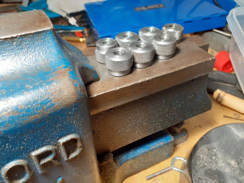

Just some M8 thumbnuts for the railway - this is the last half-dozen. Think they hold some kinda QD screen over something or other.
blush
Material was a bit of 7/8" brightdrawn steel, but I don't know the spec. It was nasty - grumbling when cut, hard to get a decent finish and trying to work-harden when parting-off. I needed quite a bit of WD40. Last time I met anything like this it was alleged to be EN8.
My old push-type knurling tool still works, despite it's cheesy-soft sideplates, if you angle it slightly towards the chuck so as to make it bite on the nearside without having to put too much pressure on the crossslide. But I think its retirement is approaching.
Oh, the nut on the far right with the coarser knurl is the sample I was copying.
