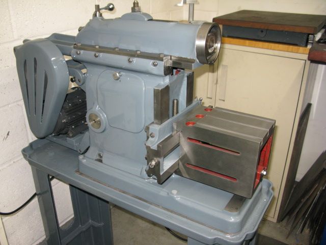

Got my Acorntools shaper project running for the first time today and spent a happy half hour watching it swish back and forth as the feed ratchet clicked away. Mesmerising, and it makes a change from cleaning and painting, which is all I seem to have done for the past few weeks.img_0403.jpg

So you don't want to refurish mine too Dave?
