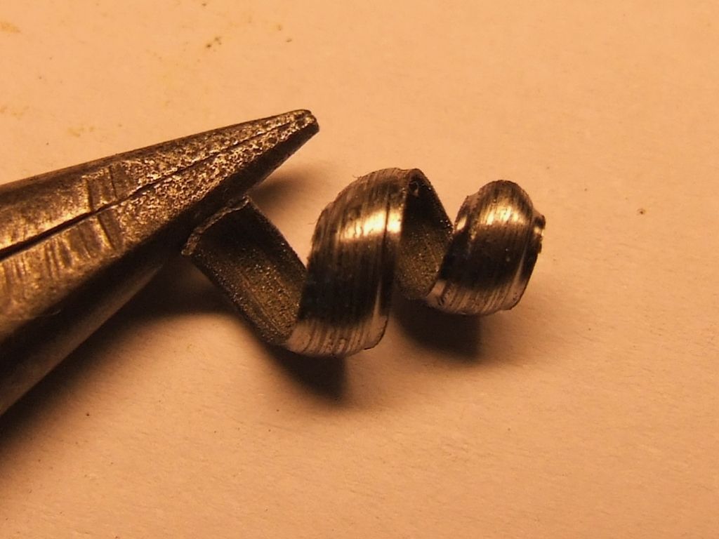

24/03/2023 21:25:09
Posted by Clive Foster on 24/03/2023 20:57:46:
...insert type tools have concave top, bending the chip to make it narrower than the slot...
The shape of the swarf from my insert parting tool:
Parting off under power feed gives a very good finish on the part, and on the remaining stock. So no cleaning up is required. One has to look at the whole picture before saying something isn't necessary.
