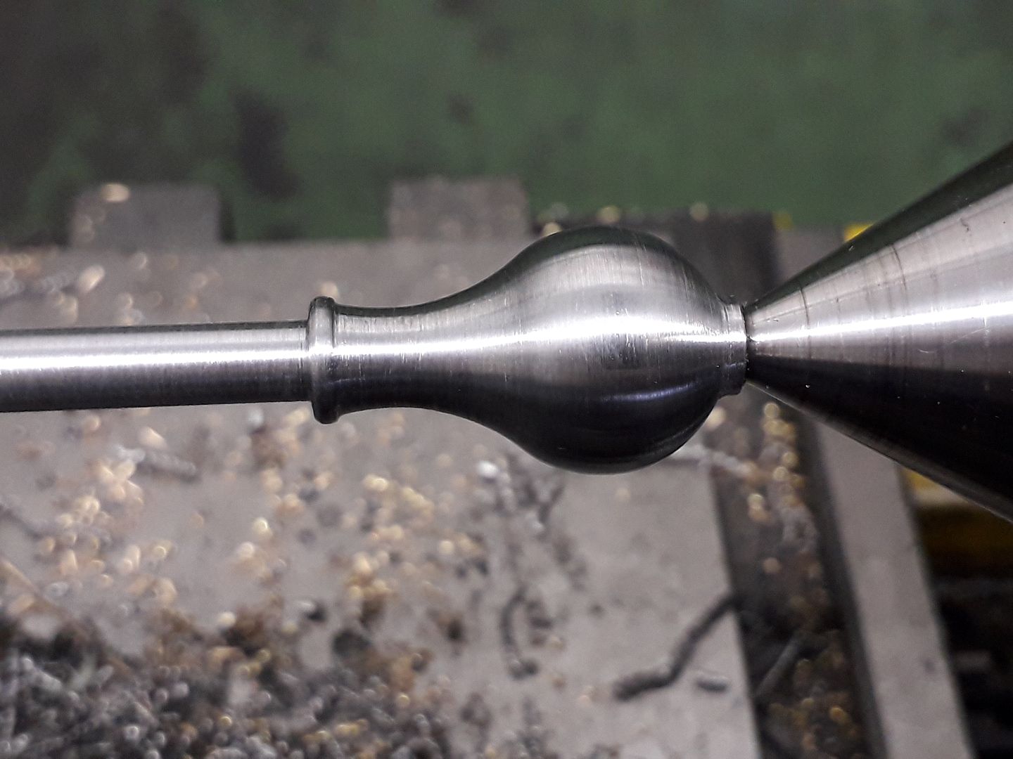

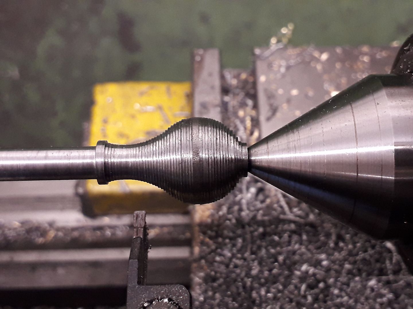

Thread end of stock, stick it on an arbor and two setups of my ball turner and that's the lathe work dine. Transfer arbor to ER block and setup on mill for beak and tail holes. My ball turner is OK for those sizes and more.

Regarding the weak M6 arbor. Best option would probably have been to form the "head" while holding by the OD of the stock in a 3-jaw chuck. Then mount on the 6mm arbor and use a female ctr to add support to the "head" while the "body" is machines.
Or you could leave a pip on his head for a small ctr drilled hole for use with the rotating ctr and machine off the pip once the larger parts have been machined
