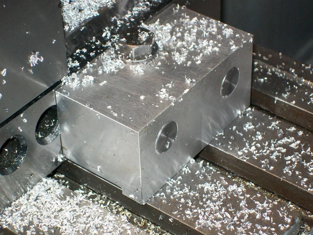

Scott, a chunk of aluminium from the scrapbox of unknown type, the pins are recovered printer shafting pressed in with an interference fit of around 0.0005" ish I didn't even case harden them and they have worked fine for years.
No plans just machined to what looked like reaonably sturdy dimensions, something worthy of note though the hole centre spacing in the vice wasn't as accurate as you might expect with on average 0.020" difference.

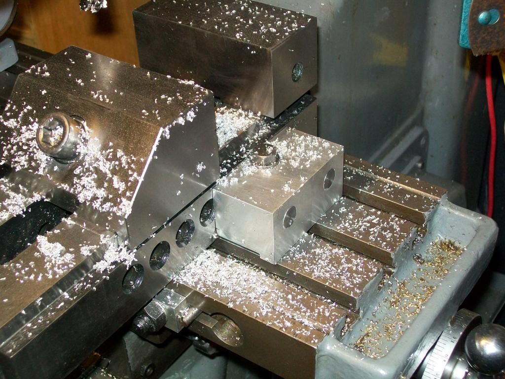

Posted by Scottmk1 on 16/07/2013 21:21:20:
Hi George, does the 4" precision type 2 vice have lugs on the body to bolt it to the machine table?
I have the type with holes in the side but made some of these to mount it on my milling machines and shapers, here is an Arc 100mm precision vice mounted on my small Taylor Mill (18 x 6" table)
