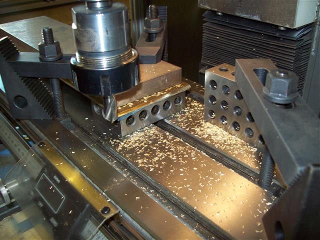

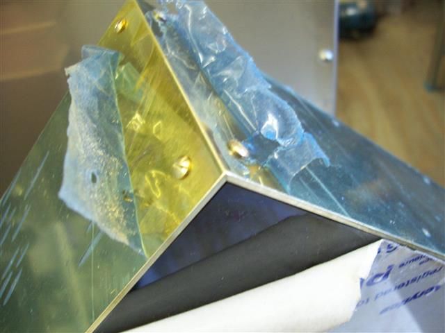

One of the finished jointsMitre JointQuite chuffed about a bit i got done today. The clock face will be black perspex on an ally frame which will have brass sides. The brass is 16 gauge and i wanted to mitre the corners (83mm wide), so this is how i did it. 10mm cobalt spot drill 90 degree point used as a milling cutter. The pic of a finished corner is not too good but the joint is spot on, on all four corners no less. WOOHOO !
Cheers Derek.
Mitre Joint P.S. Two months late, but Thanks Dennis
