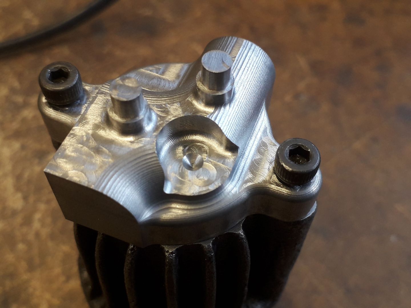

Having spent quite a while on Frday evening and even more on Saturday flicking teh RMC type A flywheel round I came to the conclusion that it is not going to work on propane instead of the now unobtainable MAPP gas I drew out a new head for it last night so it can be built as a 4-stroke, did the CAM this morning and then after lunch got the Sieg KX3 to spit out the new head in just over an hour. Still needs some holes here and there but will do those on the lathe and manual mill and then give it a lick with the needle files to get rid of the contour lines..
