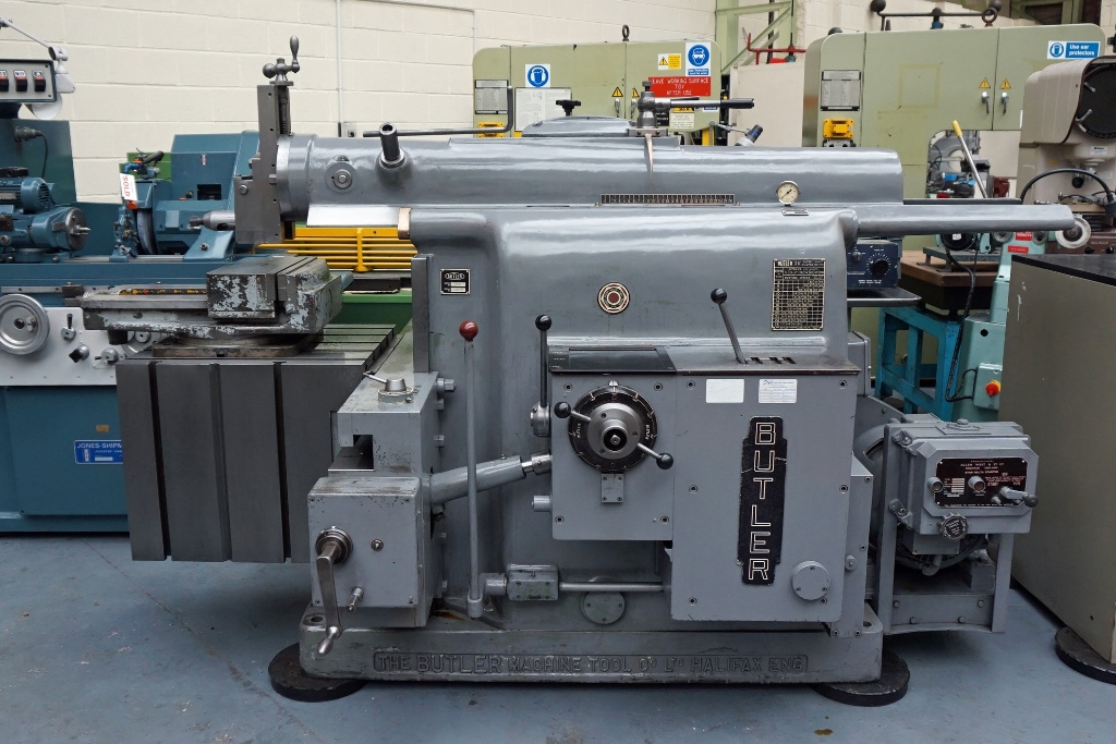

Ajohnw16/09/2016 14:39:38
3631 forum posts
160 photos
Posted by RICHARD GREEN 2 on 16/09/2016 14:24:41:
iT'S NOW £85.
This is the sort you want.
From memory they may have the box on the wrong way and the vice isn't correct either. T - Slots across and fixed jaw taking the cutting load.. Don't think there is much worry on both scores on small ones but the fixed jaw aspect might matter.
It was one of that sort of size that I saw messed up cutting a dovetail in a replacement lathe cross slide.

RICHARD GREEN 216/09/2016 16:19:27
329 forum posts
193 photos
John,
We brought it home on a trailer....................something like this............
