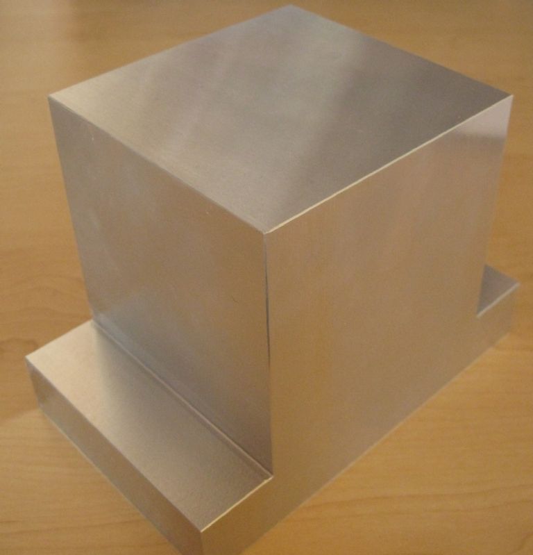

The onto the ATC main body machining - this was done in the 4-Jaw and was a little daunting. The chuck is 200mm OD. The block is 110x110x130 with 2 'ears' ( mounting feet) protruding 30mm from the base end.
I could not swing it faster than 380-400rpm without the lathe starting to shake..The hole bored is all of 90mm deep, 95mm OD at the mouth with a tapered section as lead in for a pneumatic seal, then reducing to a 90mm hole.

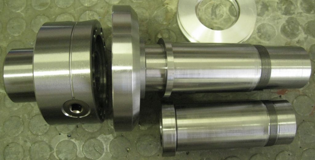

Further progress in the CNC Lathe - New Spindle
As mentioned before, the current headstock/spindle arrangement , although good for rigidity with zero collet chuck overhang, is a problem for the tool changer - boring bars and drills with crash with the headstock when turning conventionally.
So I decided to remake the main spindle, with a backplate to fit a small 4inch 5C collet chuck. The ATC tool plate is now designed to have the long axial tool clear the chuck diameter.
The spindle at bottom is the old short one. The backplate is seen not yet fitted.
Backplate below, before drilling and fitting to spindle.
Backplate drilled , tapped and fitted to spindle. The 4 peripheral M8 holes are for grub screws to adjust the 5C chuck to run true when required. The 3 holes between spindle and backplate are to lock the backplate in place, with 3x M6 grubscrews, and locktite on the spindle/backplate interface and grubscrews.

Spindle assembly done.
Headstock assembled - backplate runout axially and radially is around 0.008 max - will true it up on the lathe itself.
