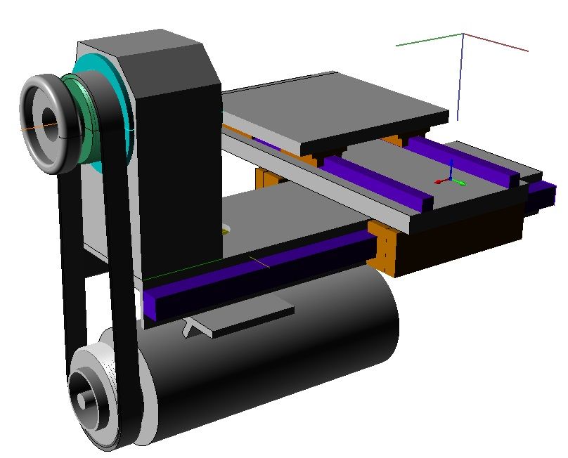

In between many projects I have a long standing one that I have finally made a start on - A 'small' CNC Lathe, build from scratch, not a CNC conversion...
The concept started small, an ER40 Collet spindle, 6000RPM capability, sort of 400mm x 400mm footprint...And then it Grew-some... I have a very nice pair of Taper Roller bearing, P5, but Imperial1-7/8 inch ID and thought to use them so moved to a 5C collet spindle. That allowed larger diameter work, so the bed grew to accommodate - to be made from 140mm wide U channel, 8mm thick. The Headstock to be made from a large chuck of aluminium, 7075 - I decided Aluminium is ok, it will conduct heat away easily, and the intended use is intermittent anyway. And so the size of the machine grew to be bigger than what my Mill is comfortable with and the challenge is now there..
I did some rudimentary 3D design to get basic dimensions, and started by making the spindle and basic headstock assemblies.
Some renderings of the concepts:
The underslung motor is a 1KW 80VDC motor - to be driven by a GECKO servo drive with an encoder fitted , ie, a proper servo drive so the spindle can be positioned to any angle, do screwcutting easily, etc. Brushes don't bother me, again, service is not production...and I have the motor and GECKO drive..

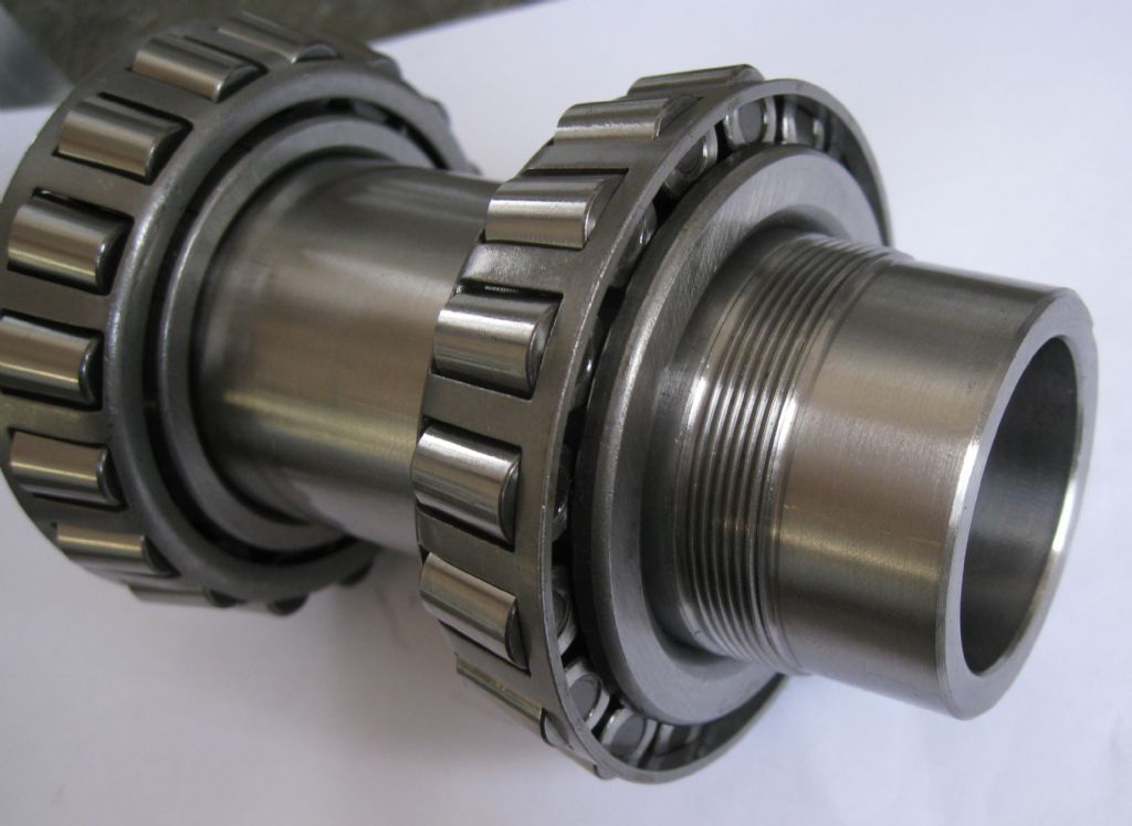

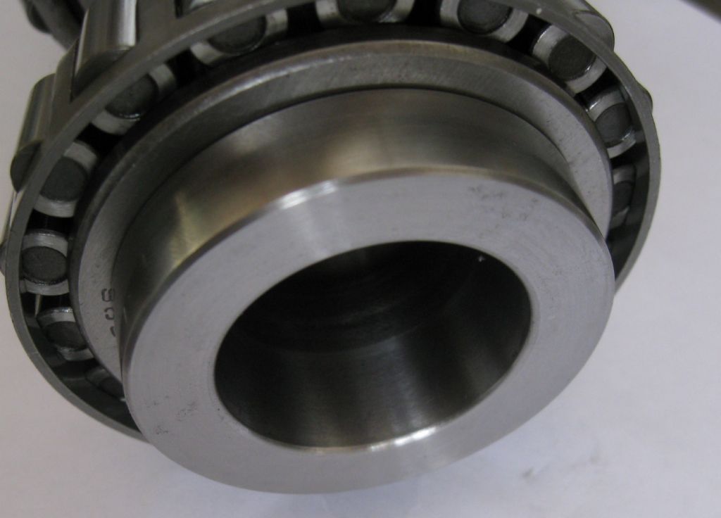

I found a very nice ( even If I say so myself..) 5C spindle, hidden in a section of broken Rear drive shaft from a large Caterpillar at the local mine vehicle repair 'shop' - I just had to dig the spindle out from the swarf in the shaft...
Spindle all machined, and ground internally, and externally for a very snug bearing fit. 5C collet end seen here.
rear or closer end seen here.

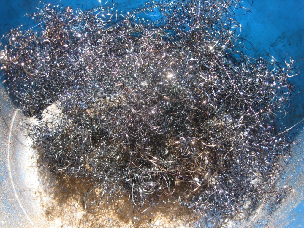

Was hidden in a few buckets of this nice shiny blue swarf..The swarf came off HOT, sometimes flaming at the cutting edge, with a shiny smooth cut surface - no idea what the steel is!

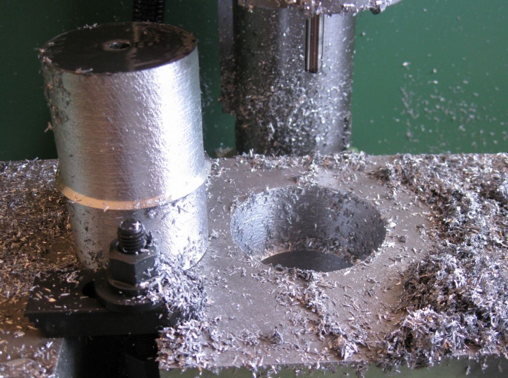

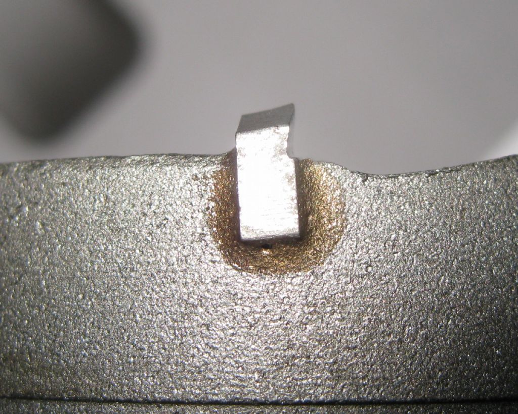

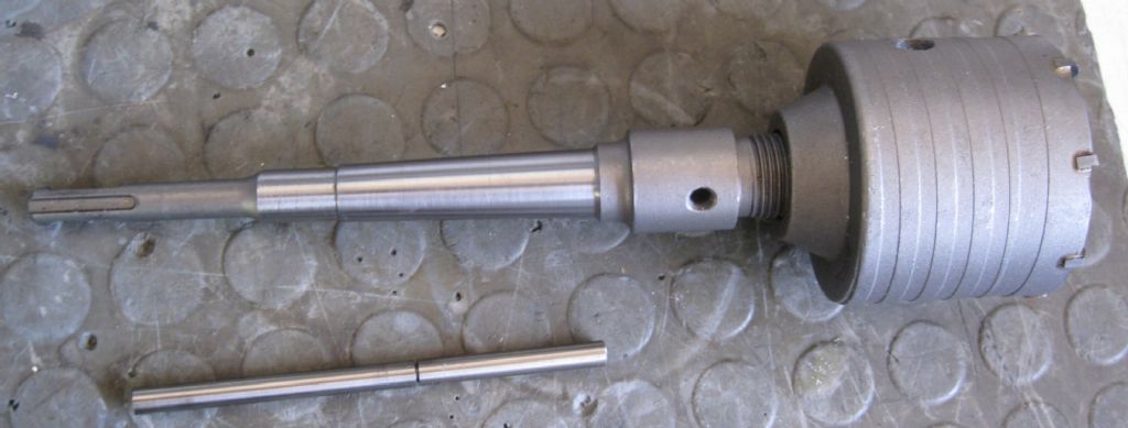

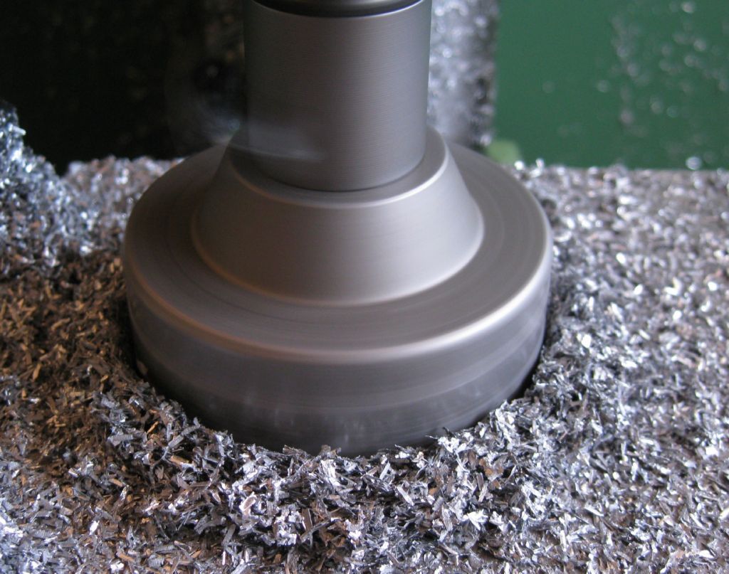

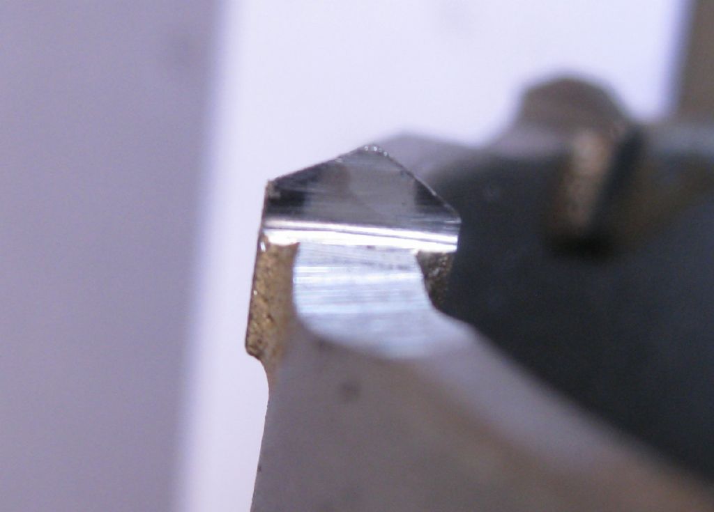

This is a big block of Aluminium - 150x200x100mm - I need a hole through the 100mm depth, 70mm diameter or so, so tried a hole saw - waste of time - just clogs up and takes forever. Drilling and boring out increasing each time was just too much, so I purchased an SDS drive concrete coring bit - 70mm OD. Turned a MT2 taper on the drive shaft ( very nice steel too, that drive shaft!) and sharpened the cemented carbide teeth on the core bit - gave them a good positive rake. Set up in the EMCO FB2 mill and drilled a core out the block - took 31 minutes...
SDS Coring bit - with taper machined on shaft
Teeth sharpened:
Front view of teeth:

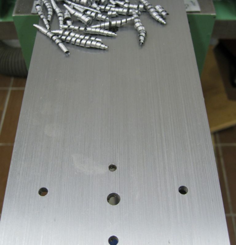

Making the hole:
The cored piece..done from both sides - lots of chatter, etc..

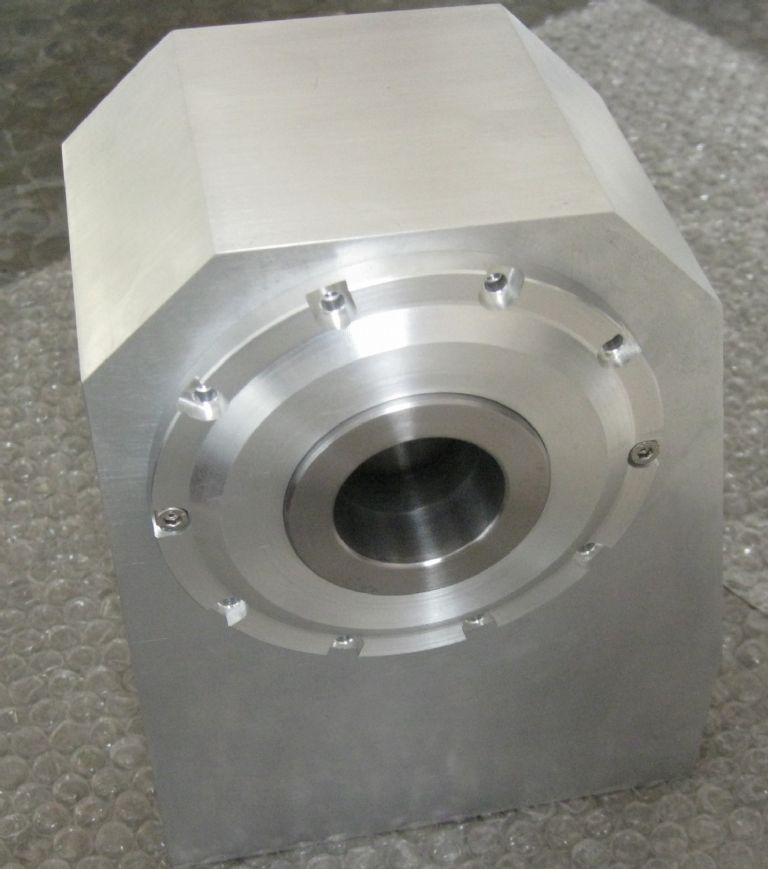

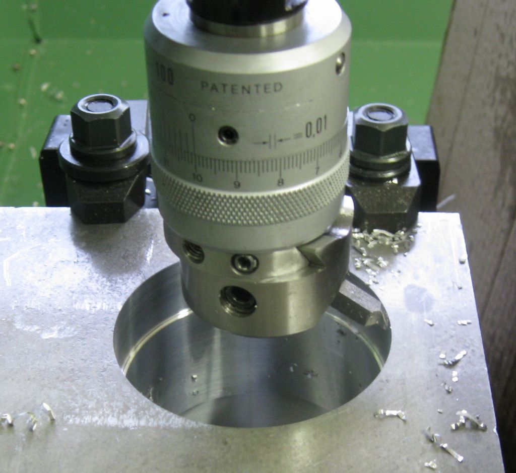

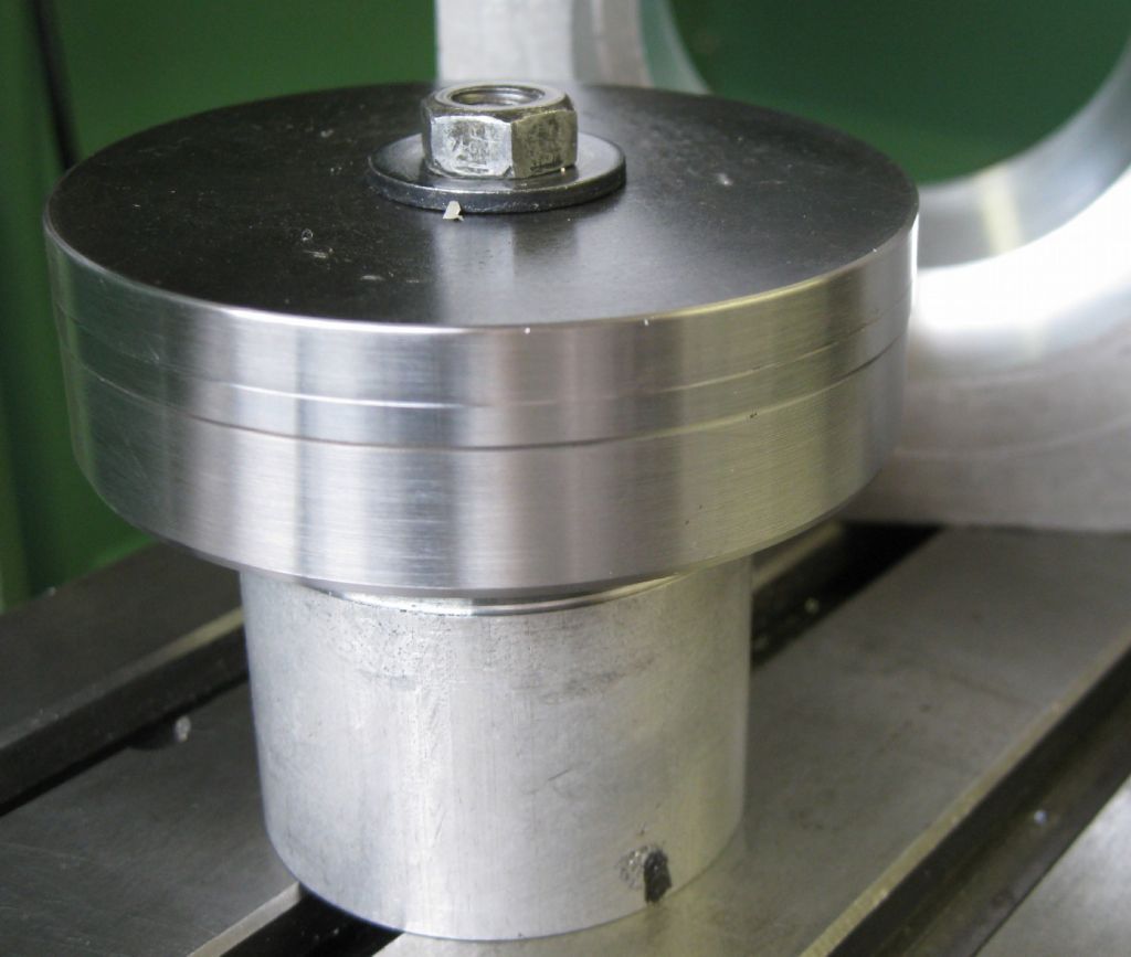

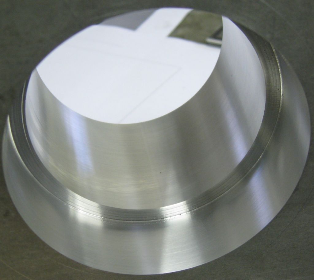

Then boring out the hole and boring out for the bearings - rough bore first
The bearing boring had to be done from both sides, and I wanted the holes lined up to better than 0.005mm....

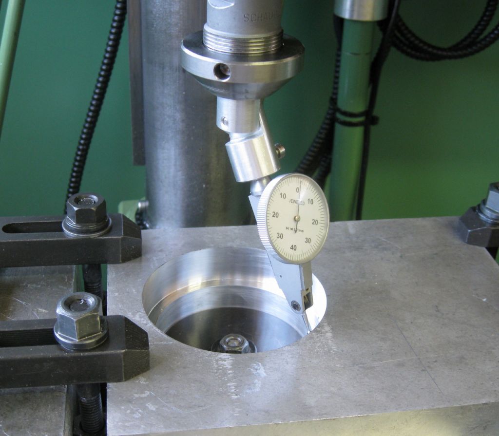

So a mill tramming took place, which is covered in Graham's FB2 thread - took 2 days with lots of effort - was worth it!
The idea then was to fit a locating boss to the table, which would snug up into the inner bore. fasten the block down to the table, bore the bearing hole out, and then rotate the block over 180deg, slip over the locating boss, and do the second bearing hole. The boss was made from a hard steel, polished, and 'just' fits in the inner bored hole - it is a real bugger to get the block down on it - cannot be slipped over even a little skew...
The boss:
The block slipped over the boss, and checking for center location before final boring of second bearing hole.
The headstock block bored out:

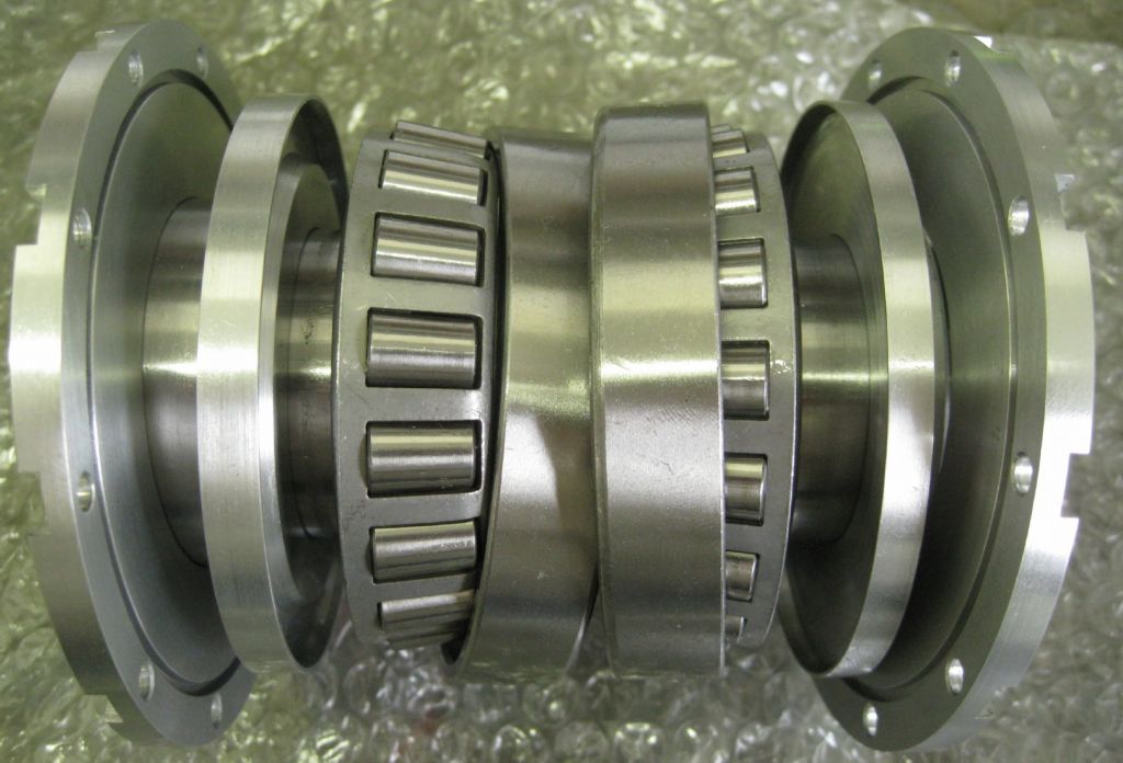

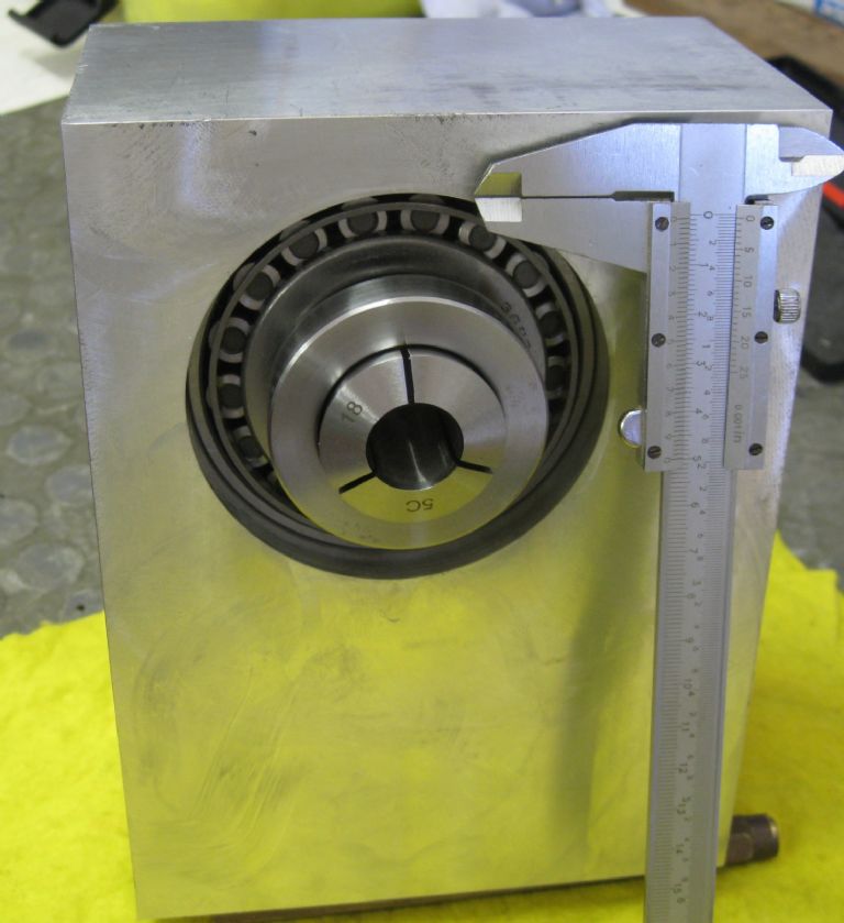

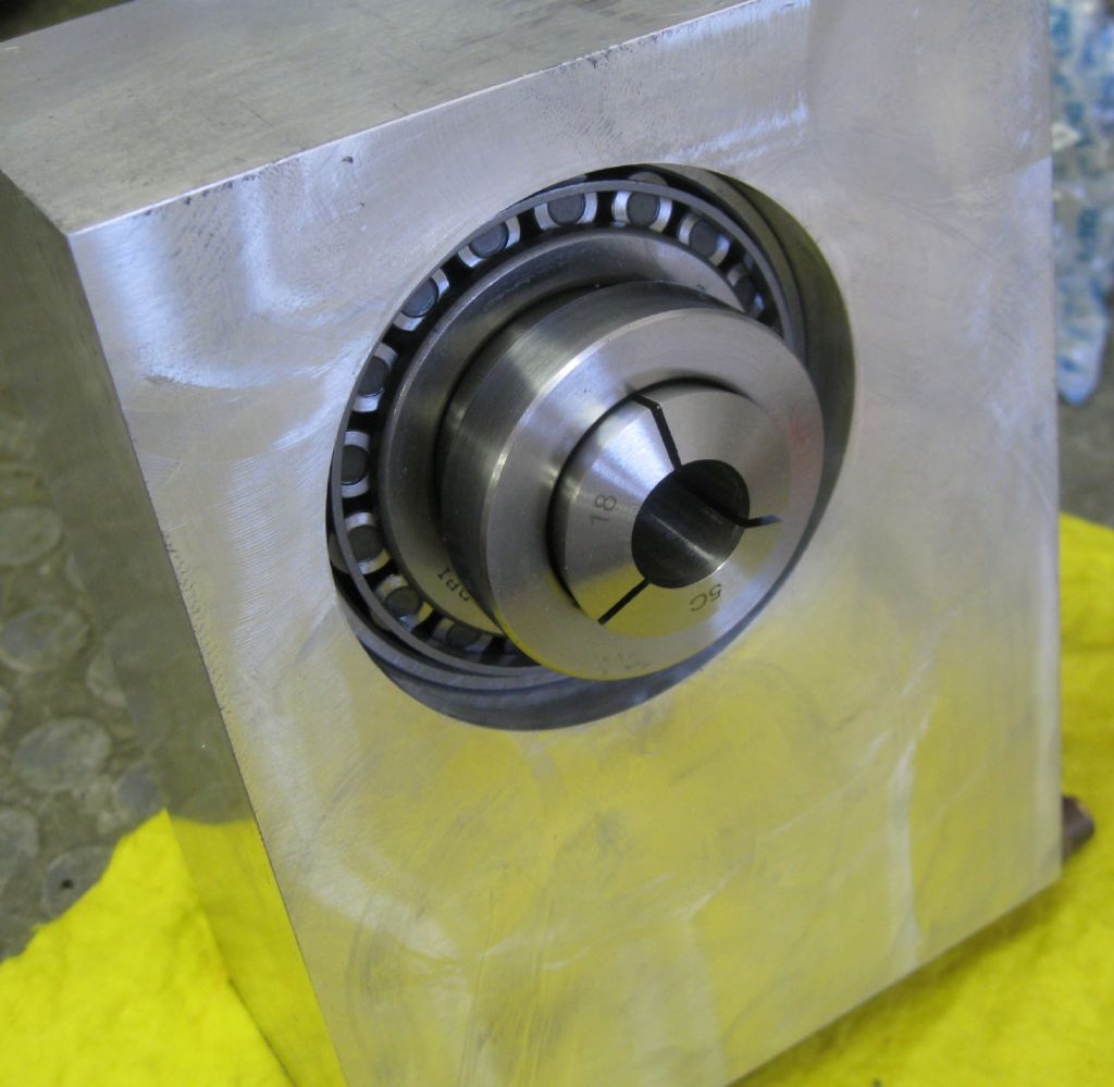

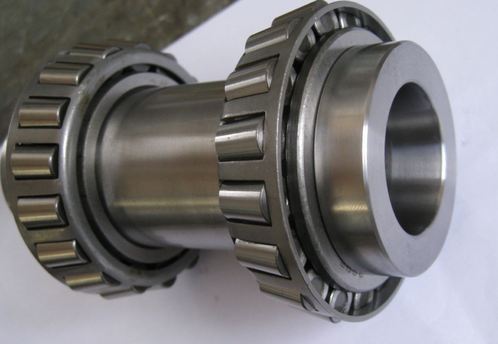

Bearings and spindle test fit:
Next up - Labyrinth seals...then the bed - in the shaper and more such fun..

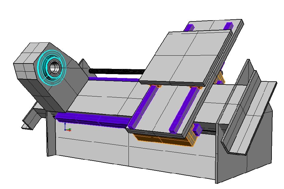

Joseph Noci 114/11/2020 20:11:37
1323 forum posts
1431 photos

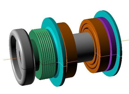

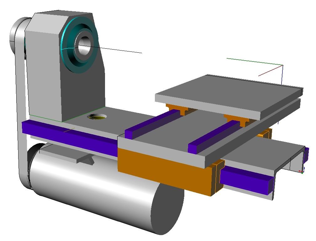

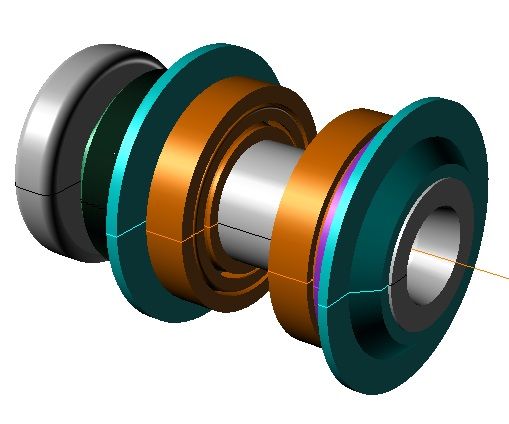

Some Progress on the lathe - Headstock is mostly done. Oil plug and breather hole still to do, and then pulley and collet closer..
The Lathe Concept slowly solidifying as well:
Exploded spindle with oil flinger rings and face flanges

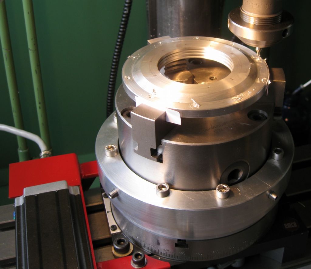

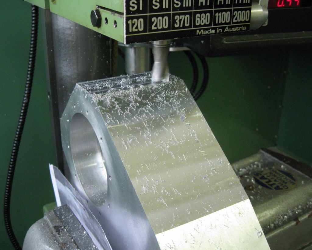

Milling the headstock:
Drilling / Milling out the Face Flanges on the Automated Rotary table

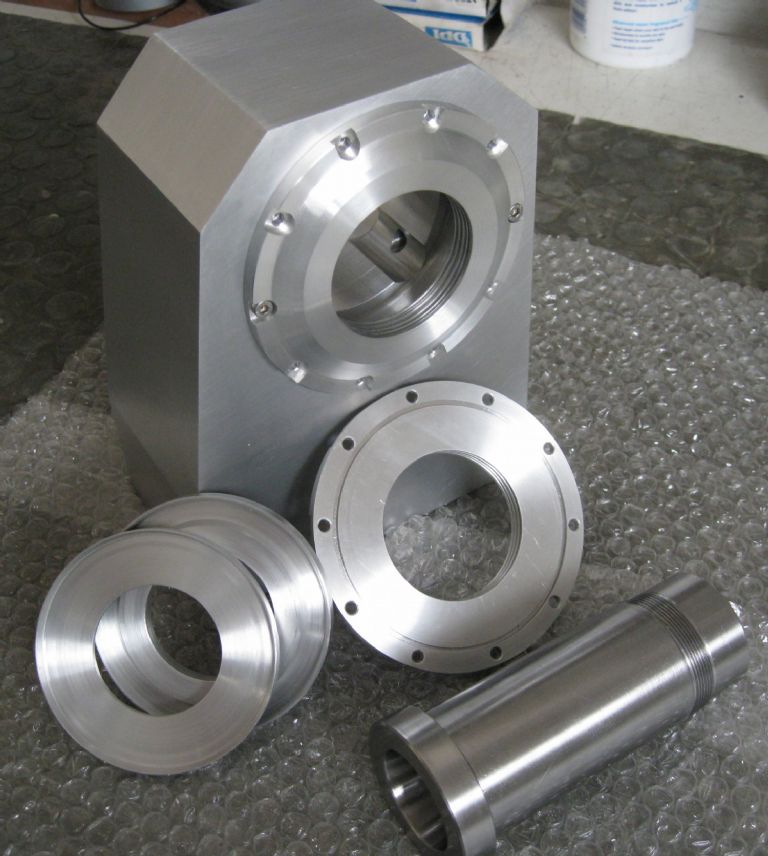

Headstock parts ; Spindle, flingers and face flange ( seen from O ring oil seal side, below)

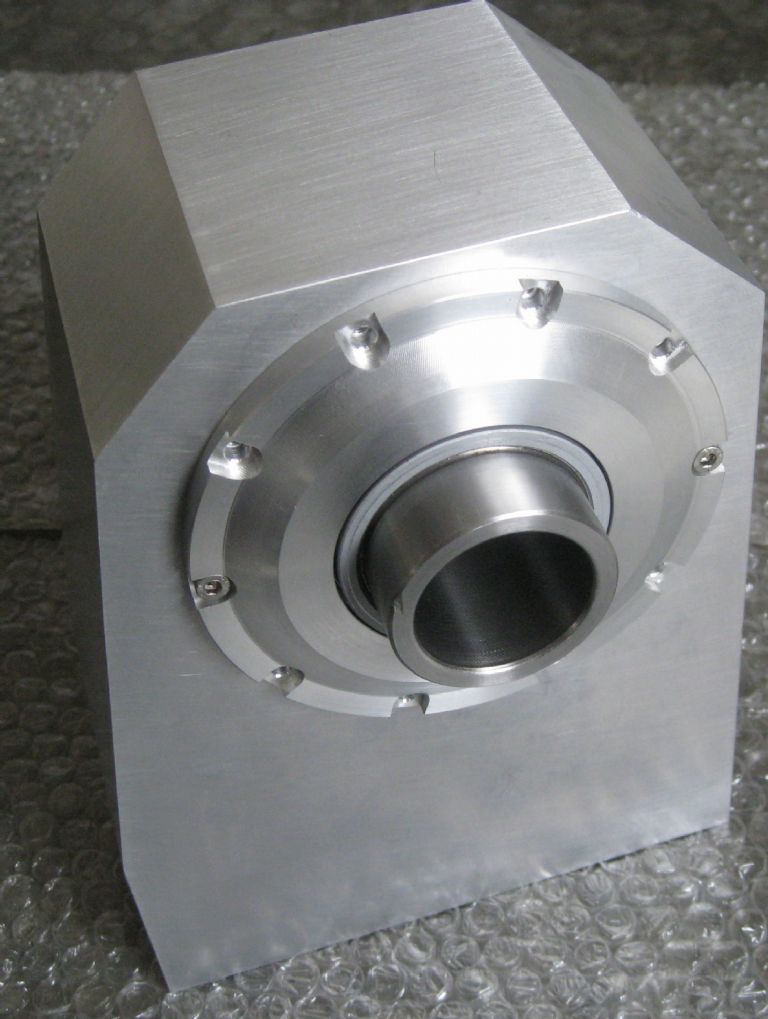

Assembled Headstock, collet end.

Flattening the bed top:
