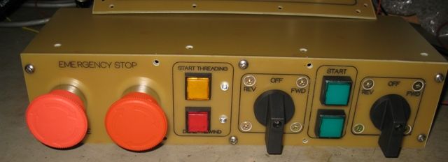

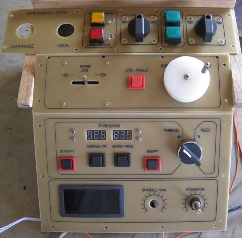

There is a Main and a Sub control panel - the Main is above the Headstock, with the Sub below the Swarf tray, left of the operator, at left pelvis height - main start stop buttons, etc...

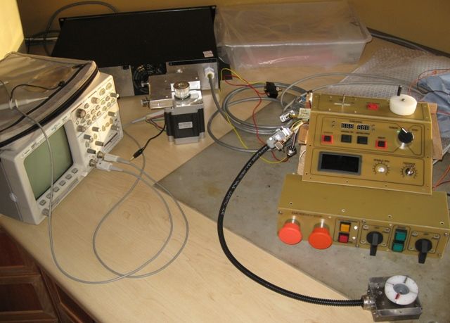

Upper image is Sub panel, lower is Main, on the Bench in the Lab for SW testing.

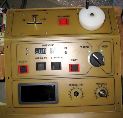

CLoser view of Main Panel ( forgive the flash-back..) Managing setup selections.
And the Sub Control panel, managing actual Machining.

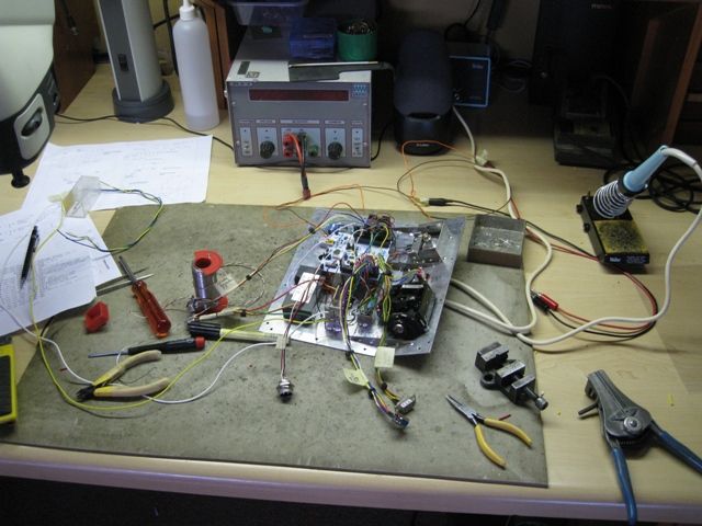

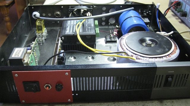

The system Power supply and Stepper Motor Driver module.
Housed in a re-purposed housing taken from a Phonic 100watt stereo Audio amplifier that had let the smoke out...The Toroidal mains transformer was ok, and suited this job just fine!

Testing the SW on the bench...

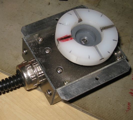

The main spindle magnetically coupled Rotary encoder - DIY from a 1024 ppr encoder wheel from an old Calcomp plotter...Provides 1024 ppr Quadrature output with a 1PPR reference pulse - essential for the start of thread point - acts in the same way as the single tooth dog-clutch in a mechanical threading clutch ( Meek, et-al..)
The encoder unit fits with two M3 screws on the rear cover of the lathe, lined up with the spindle , and the 4 rare earth magnets in the polyprop disc line up with mating magnets in a disc fitted to the main spindle - there is not enough space to fit the unit inside the cover with belts or gear drive, etc. This has a limitation - I cannot thread a rod that has to protrude past the rear of the spindle...But I could fit the shear pin back and do it manually! 99% of my playtime has not involved threading work that long...
