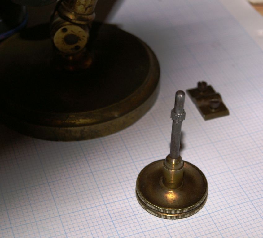

I had to repair one of Flemming's brass microscopes with just this problem.
It was a straight cut rack and the pinion had lost 3 teeth.
I managed to build up the 12 tooth steel pinion with a tiny welding electrode, skimmed it true, then ground a profile tool to cut the teeth with the lathe as a shaper.
