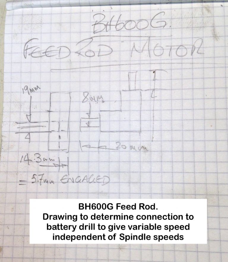

I have at last made a start at fitting the battery drill as suggested by Bazyle, in conjunction with an Angle drive.
New Album added.
Advise needed please on the connection between the FeedRod and L-Drive shaft.
As can be seen the connection is only 5.7mm hidden inside the Rod End Cap, and I'm not too happy with this.
Was thinking of drilling the end of the FeedRod to take an extension piece, extending it past the Rod End Cap, thus giving more depth for the L-Drive shaft as well as more choice of using different motors if needed..
I need for sort this out, as the FeedRod with Worm Gear and Key can only be assembled together with ease whilst the Apron is off of the lathe.
Thinking cap on, and the following solution came to mind; Secure the extension piece using a roll pin that can of course be easily knocked out once the FeedRod is slid sideways, when it's roll pin, at the Gearbox end, is removed.

Perhaps you could drill the shaft and put a couple of internal keyways in. Then put a pin throgh the motor shaft to engage, all slightly loose to give a degree of flexibility. Slightly more elegant than the even easier sawn slot across the end. When I mentioned a drill it was just the sprung clutch I was thinking of not the drill motor. Will it have the right speed torque range, and if running slow think about cooling too.

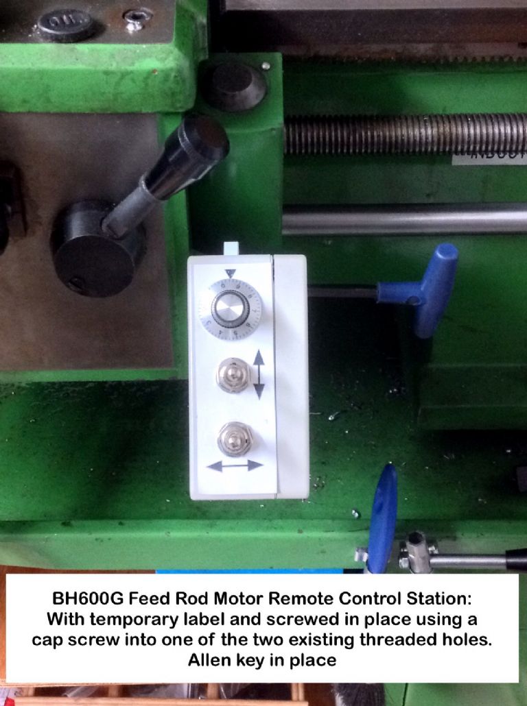

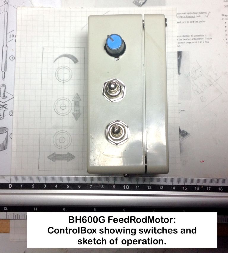

Back on track at last, but need help please, this time for ideas on how to mount the remote control station to the side of the Apron, but able to be removed easily, so a slide-in housing of some sort.
It's being mounted where the Spindle Direction lever was and no longer needed.
Depth of Apron is 60mm.

Remote Control Station front showing controls and sketch of proposed decals:
BH600G FeedRod Motor

Les Jones 124/12/2014 14:10:39
2292 forum posts
159 photos
Hi Geoff,
One suggestion. Make two keyhole slots in the back of the control box to match the existing threaded holes and make two shouldered screws to fit the existing holes.Also make a springy plate to go on the back of the box (Or fixed to the casting under the shouldered screws.) so the box had to be pressed against the casting to hook it on the keyhole slots. You could also counterbore the inside of the box at the top end of the slots so the box had to be pressed against the casting to remove it from the keyhole slots.
Les.

OuBallie06/01/2015 14:23:50
avatar
1181 forum posts
669 photos
Les & Bazyle,
Thanks for the suggestions.
Fitted the Threading Dial and that prevented the RH tapped hole from being used as it wouldn't allow the Remote Control Station (RCS) from being swivelled into a more useful position to operate the switches.
I had already drilled one hole in the RCS some time ago, so just measured up and drilled a corresponding one in the cover in order to pass an Allen key through, and into the cap screw head.
This works a treat, and can be tightened up so preventing the RCS from swivelling, now that only that one fastener is used.
Used TouchDraw to do the label, emailed it to myself then printed it out at 30%.
Just need to make a permanent label, with thanks to and as per 'mikesworkshop'.
