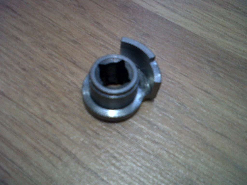

I'm not sure how difficult it would be to reproduce these in steel? your thoughts pleasecam1.jpg

I suppose a lot depends on how many you need making and a rough idea of what you'll be using them for - they look like a catch or a lock to me.

Yes, it's a part out of a locking mechanism, I need at least 25 of them, I'd be looking to pay around £5.00 each to have the part reproduced in steel, the die cast is prone to failing and breaking up.

£125, that would not even cover the cost of an 8mm broach to make the square hole unless someone willing already has one.
Do you have a CAD drawing as that would be the quickest way to make them and would save you paying someone to also measure teh part & draw it up

unfortunately no, I thought the square hole may have been the sticking point..

steel componenthere's one in steel, so it can be done, not sure if the square corners have been achieved by broaching..

they have to hold their own in terms of mechanical wear and tear temp range -10 to +30 degrees Celsius outside temps, good shout though

That's looks like it's part of a UPVC style door lock?
I have a door at previous workplace that always breaks those, it's a nightmare, we replace the lock every 6 months - 1 year!

bang on! upvc door lock the whole unit costs £100.00ish,
I've done some digging and have managed to source them in steel ~ delivered £22.50 each!! grieves me to pay it for such a small component, but hey such is life,
wax casting in mild steel? that sounds interesting.. Tell me more about the process.

Probably cost £50.22 in lost wax and steel casting wink

If I was making a small run of those I'd silver solder two bars with 90-degree vees in together to make the central square hole.
Not for £5 each though.

Stack them up and wire erode the square hole
