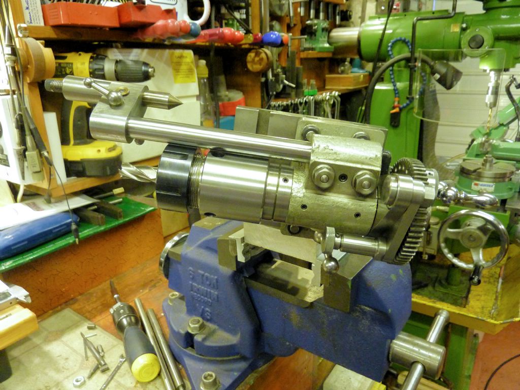

Chris Heapy17/05/2013 11:54:59
209 forum posts
144 photos
I've had a root about in the workshop cupboards and came up with this combination, I'm thinking it may be the basis for cutter grinder? The Myford swivel slide has sat in a draw for years - not used it since buying a mill. The quick index head is part of the GHT dividing kit I made, and the collet chuck is off the lathe. The center bar could be used to locate the cutter flutes (somehow). Maybe if this lot were bolted to an X-Y table I would have the axes of movement required.
